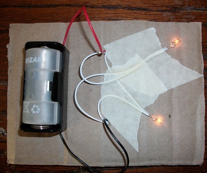

Step 2: Make the Circuit
I did not use a soldering iron. I connected one of the connections underneath the piece of plastic. This is why you do not see it in the photo.
I specified four transistors in the parts because you can connect two transistors in parallel to improve the reliability of the circuit.
I suggested that you purchase more LED because you might burn a few.
