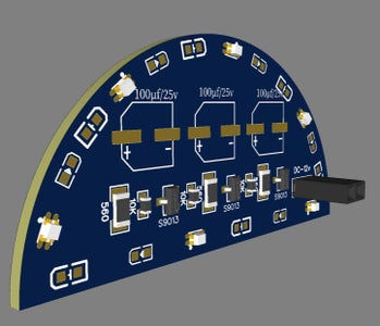

Step 5: Schematics and PCB Design
The schematics of PCBs can be seen above.
Step 6: Circuit Connection – Step 1
To make this flip-flop circuit, 1st we connect 3 pieces 10 KΩ resistor with “Base” leg of transistor. Then we connect 100µf/25v capacitor negative leg with “Base” leg of transistor and its positive leg with other transistor “Collector” leg.  We follow this process with the rest capacitor also and connect its empty terminal with 3 legs of 10 KΩ resistor.
