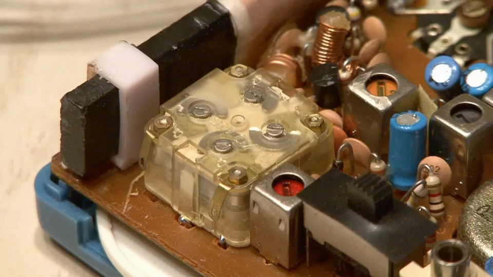

Now we need to locate the components we will be modifying. First, look for the main tuning capacitor. It will be a square, usually clear, compartment that houses the tuning controls. It will be right next to the tuning wheel. Near the main tuning capacitor you will see two coils of copper wire. These are what control and limit the frequency range of the radio.
Step 3: Tuning Transformers
The tuning transformers are square transformers with tuning slots in the top. Mine had five.
TIP: The best way to locate the one we will be adjusting, is to look for a couple of diodes closest to one.
Step 4: Get to Work
Now, turn on the radio and tune it to the clearest station on the high end of the FM band, near 108.
TIP: Confirm you have found the correct copper coil (one controls AM, the other FM) by touching it with a screwdriver. You should hear a change in the station.
Using your screwdriver, slightly spread out the copper coils. The station will fade away and you have just increased the range on the upper end of the FM band beyond 108MHz!

Tune the radio in between two stations where you can hear hiss. Adjust the tuning transformer until the hiss is the loudest. Turn it slowly to hear the change and make note of where you started so you can return it to the original location if you want to reverse the modification.
