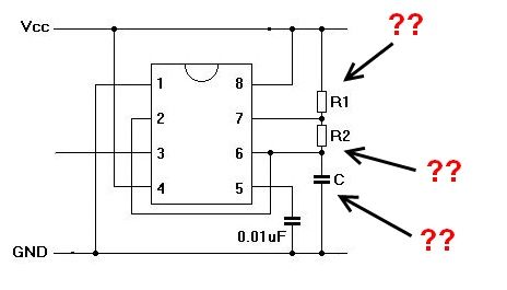

If you want to make it more advanced, I put another schematic in the pictures selection. Here the NE555 timer switches the Base on and off, so you're sure that it's really working. This is a little bit heavier to make, because you also need a few more resistors and a capacitor, and a good prototype board. In my prototype board the holes are to far away from eachother, so a chip won't fit in it. You can also use a breadboard for this. Depending the resistors and capacitors you use, you can chanche the frequency from switching the Base.
