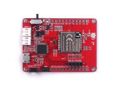

For supporting the LoRaWAN, I purchased a LoRaWAN module—Ra-07H. I design one Maduino board that features the LoRaWAN module and SAMD21G18A microcontroller, which to be the LoRaWAN node supporting the Arduino. The Maduino LoRaWAN board provides many expansion GPIOs for connecting the sensor, that meets my need to connect the DHT11 module.
The Ra-07H module already has loaded the firmware that supports the AT command. According to the Maduino LoRaWAN board schematic, the Ra-07h connects with MCU through the serial that you can send the AT command to LoRaWAN module by serial.
Next, I was going to start transmitting the data by using this board.
