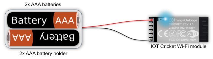

- IOT Cricket WiFi module
- 2xAAA battery holder
- 2xAAA batteries

In the first step we connect batteries to Cricket.
