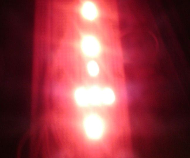

In this instructable I will show you how to convert music to varying light intensity and then transmit it wireless using an LED and a solar cell whose output it seen by a speaker.

Step 3: Transmitter & Receiver
Connect the 9v battery in series with the audio jack then connect it to the led.
The tip of the speaker jack is connected to positive of the solar cell and negative is connected to the body.
