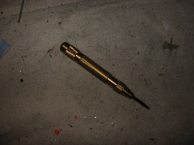

The first thing to do is identify all rivets that run through the transom. In my case I had 16. After identifying the rivets to remove, mark the outside of the rivet head with a black dot with a sharpie. No use drilling out a good rivet.
After marking the rivets to be drilled out get your drill and get to work. Besides replacing the rivets with carriage bolts, this is probably the most difficult task of the process. Use a spring loaded punch to start a divot on the rivet head so your drill bit doesn't go all wild. Drill the rivet head as least as possible, once you see the head is about to be drilled through, stop immediately, no use making the hole in the hull any bigger than it needs to be. Repeat this task for all of the marked rivets. When you are done, the transom should be loose and with a little coercing, be ready to be removed.

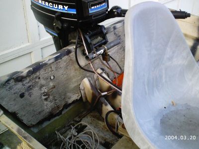

On to fabricating the replacement transom: Most, if not all wooden transoms in smaller boats are made of plywood. From the looks of the transom in this boat, I would estimate a typical transom will last about 20 years or so before they need to be replaced. This boat is a 1972 and the pictures were taken in late 2007 and as you can see, the transom was in bad shape. It should have been replaced years ago.
The first thing to do is to take the old rotten transom and use it as a template as best as you can. Some of it could bee missing due to rot and whatnot. Do your best to draw that area in when tracing the template. Since we're using ½" pressure treated plywood, you're going to be doing this twice. Go ahead and cut out your first piece after tracing it out, you're going to use this newly cut piece as the template for the 2nd piece.

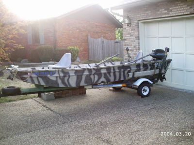

Bolt on your motor and hit the water.
