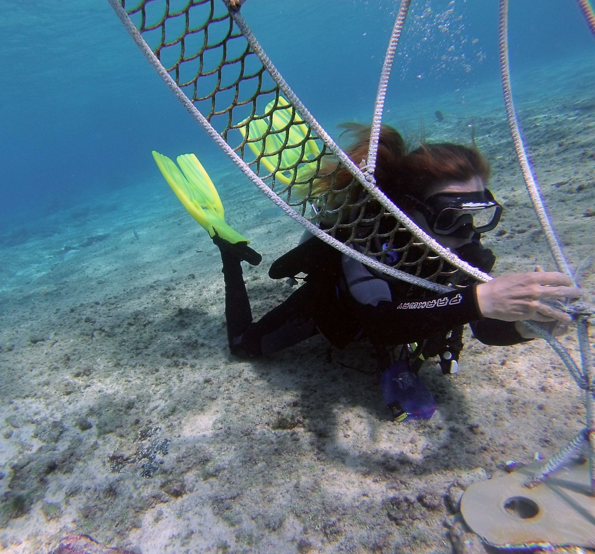

In 2004 I learned how to transplant homeless coral fragments found on the seafloor onto life-supporting, artificial reefs. The photo above was taken in Bali. As you see these are quite large pieces of coral collected with many biologists and ocean lovers, like Tessa Divina pictured, focused on methods for reviving biodiversity in areas that had been devastated by dynamite and cyanide fishing, climate change, pollution, and disease.
I'm going to describe how to easily attach much smaller fragments onto human-made reefs without harming them. This is useful for ocean and tank experiments. In another Instructable I will share more about the coral cultivation method I'm exploring, known as electro-accumulation, mineral accretion, electrolytic (or electrified) reefs, and recognized as offshoots of Biorock and Seacrete. A totally fascinating amalgamation of chemistry, biology, ecology, art, electronics, and interdisciplinary innovation.
