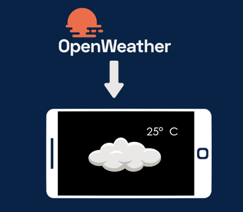

The core concept is simple: show live weather on your smartphone with animated icons. We’ll pull data from an API like OpenWeatherMap and build a lightweight app or website that displays the right visuals for the current conditions.

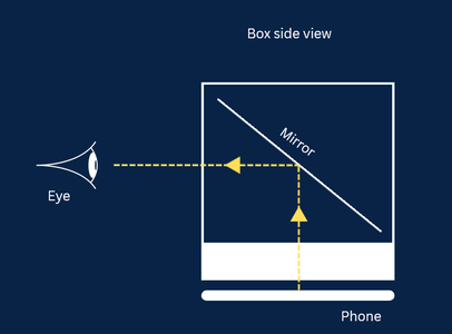

Next, we’ll construct a box with a piece of plexiglass set at a 45° angle and position the phone inside. The phone’s screen will reflect off the plexiglass, creating a convincing hologram effect!

Then, grab a piece of clear plexiglass. It’s what our hologram will be projected onto. Cut the width to match the inside of your box, and the height to the diagonal distance from the base to the top edge.
Carefully slide the plexiglass into the box so it angles down toward the front. If it’s a snug fit like mine, you won’t even need glue to hold it in place.

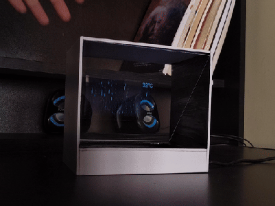

Finally, slide the phone under the box. I kept it plugged in, since the battery is mostly damaged after all these years. And we're done!
Step 8: Conclusion
And there you have it— a tiny box in which you've captured the weather! It looks amazing as you walk around, with the weather icon appearing to float in mid-air. Plus, we’ve given new life to an old smartphone that might otherwise have ended up as e-waste.
