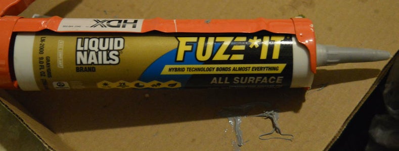

Once your pieces are all nice and dry, take the two pieces for your tabletop and adhere them together with the Liquid Nails Fuze It*.
*NOTE: Some people had issues with the Liquid Nails Construction adhesive that was white. The formula of this one (if you can still get it) is terrible and will NOT hold anything together, nor ever seem to dry. That's why I specified to use Liquid Nails **Fuze It** because this stuff works AWESOME! It's a gray color when it comes out. And anything you want to adhere together is basically stuck together after just 10 minutes. I've used it on LOTS! It's really, really good. Highly recommended!
1. Using your caulk gun, locate the little circular hole at the back in the handle. This is actually a tip cutter! Insert the plastic tip of the Liquid Nails bottle into this hole (only as deep as you want it cut), then pull the handle to cut the tip. (A little blade is inside that cuts the tip.)
2. Insert the Liquid Nails bottle into the caulk gun. To quickly pull back the metal bar for inserting the Liquid Nails container, press in the metal flat piece (that the bar goes through) and pull the metal bar back. Insert your Liquid Nails container, then pull the handle a couple times to quickly push the metal bar into the end of the container, keeping it secure. Now it's ready to use.
3. Press out a line of adhesive onto one inside piece of wood. Then press that together with the second inside piece of wood to complete the tabletop.
NOTE: Use a level (if your wood pieces are uneven heights) to make sure the tabletop is flat on top.
4. Once you are satisfied with the lay of the pieces, use painter's tape (or clamps) to keep the pieces together while drying.
5. Dry for 4-6 hours (or overnight).
