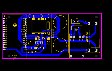

Step 1: PCB Making
PCB:
Determine the circuit you want and make a schematic on easyeda. When the schematic is finished convert it to PCB using easyeda than determine the arrangement of the components on the PCB and make the paths.
Step 2: Component Soldering
solder all components according to the schematic that has been made.  It is highly recommended to try the circuit first on the breadboard before soldering it.

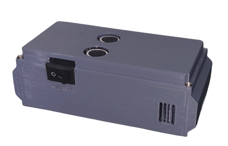

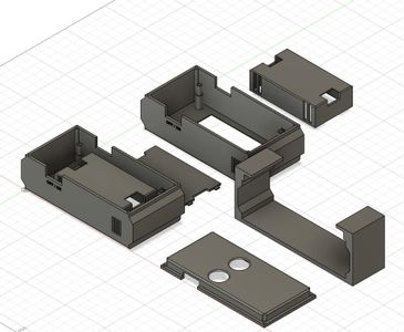

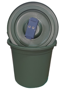

Step 3: 3D Design and Printing
3D design:
The design is divided into three main parts, namely the main body, cover and docking. The design that is made is expected to achieve the following things:
  • Can put main board and battery properly.
  • Provides inlet and battery cover to allow users to change batteries.
  • Provides holes for ultrasonic sensors, charging ports, and switch placement.
  • Allows the device to be removed from the trash can.
3D Printing:
After the design has been made, the next step is to print the design. In this project the design will be printed using a 3d printer so the design file must be exported to a ".stl" file first. When printing, you need to pay attention to several things, such as room conditions and printer settings in order to get maximum results.
