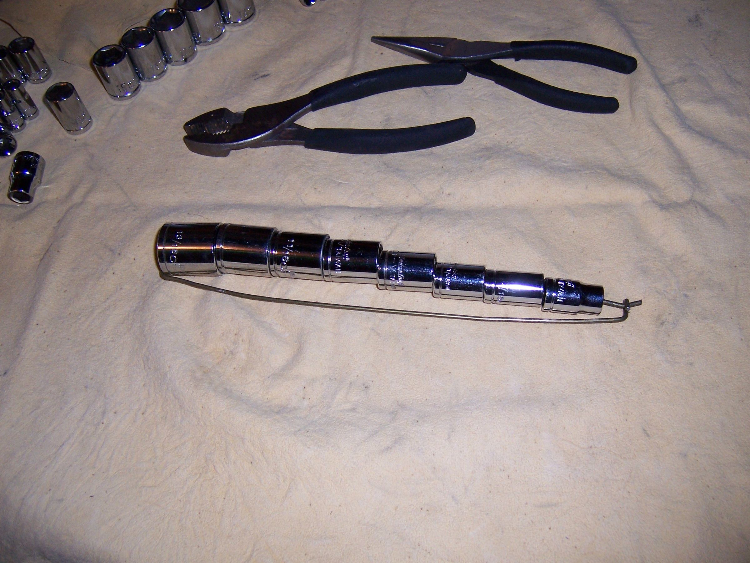

Once I'd made the cuts it occurred to me that should the rod come apart the section above the reel could fall into the water and be lost. To prevent this I made a line guide, or eyelet, for this bottom section and while I was at it I made a small hook holder for when I stored the rod fully assembled. To make the guide I used a small diameter brass welding rod and wound it around a small pipe nipple. Two pairs of pliers are a must for this step. The hook holder is a piece of the same welding rod with a small bend in it. Be sure to hammer the ends of each piece flat so they don't twist on you after attaching them to the rod. Flatten the feet a little then use a small file or emery board to smooth them out. You don't want any sharp edges left behind. A word of caution: either be very careful or wear leather gloves. While bending the hook stay my thin welding rod broke and the sharp end caught the tip of my index finger giving me a pretty nasty cut. I just needed a band-aid and was back to work. You could skip this step and just order parts from an online supplier.
