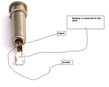

Step 19: Add Bridge, Tuning Pegs, Strings, Piezo Pickup, Endpin Jack
Add the bridge, using screws to tighten it to the surface. You may need to create 4 channels for the strings and use a file to improve the string action. Add the piezo rod pickup, feeding it through the hole and solder the positive line to the tallest post, and the ground mesh wire to the shortest post. Use shrink wrap or electrical tape to keep the two lines separate from one another.
