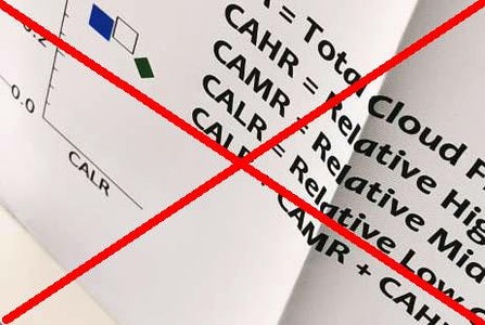

So, let's start with the folding. As we know, A0 is equal to 4x4=16 A4 sheets, and there are a number of ways to fit A0 to A4, but there are not too many ways that have a small number of sharp creases, which are difficult to flatten out. In the first picture, I show the problem using the poster I saw once, and our goal is to minimize the number of this kind of creases. The folding approach explained in the following series has only 3 sharp creases; the other ones are more or less closer to folds. For demonstration purposes, I used A4, which I folded to A8 in the series of pictures above, but the principle remains the same. Let's imagine that we've split the poster to 16 individual A4-sized sheets and numbered them A1 through A16, whereas the reverse side of the poster is labeled B1 through B16; the numbers correspond to each other, so that if we flip the A1 corner, we will see B1, and if we flip the A16 corner, we will see B16.
