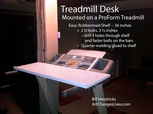

Step 5: Building the Keyboard Platform and Desk
After getting the configuration to my liking, I simply drilled holes and bolted pieces of wood to the treadmill, then screwed on even more pieces of wood. I used a plastic sheet to keep metal shards and sawdust out of the treadmill.
My keyboard sits directly on the keyboard platform. A smarter design would incorporate an adjustable keyboard tray.

Step 6: Keyboard Platform and Desk Attached to Treadmill
Here's the version with the keyboard tray and desk both attached to the treadmill. Since my second monitor is so heavy, I opted to hang it from the ceiling. My laptop did slightly shake when I was walking. While it wasn't enough that I couldn't focus on the screen and work, with a wall so close, it seemed like I should take advantage of it.
If you can't attach something to a wall, I'd recommend building a desk that sits on the ground and forms an arch over the treadmill.
