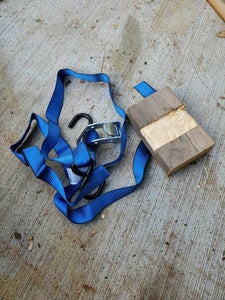

Ratchet or cam strap that you trust. I have found the 6’ long 1’’ wide ones from just about every store work fine. You want short because any tree bigger than about 24’’ around you would probably need handholds or a climbing belt anyhow. And shorter is easier to manage.

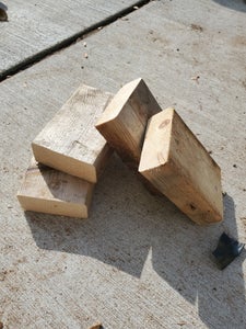

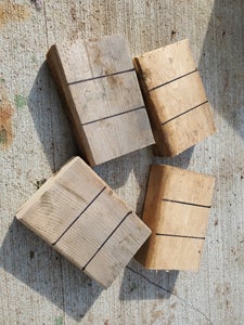

We have a lot of scrap leftovers from projects so I grabbed a 2x4 off cut for this.
I cut it into about 5’’ lengths because the scrap I had divided evenly by 5. You could probably make them slightly shorter and also slightly longer and it wouldn’t change a thing. So pick a number close to 5’’ or just use whatever your scrap evenly divides into for the most pieces.
I wouldn’t make them less than 4x the width of your ratchet strap though, you will see why later.
Step 2: Highly Calibrated Bamboo
Because this is for the “Scrap Speed Contest” I’ve used as much scrap as I could reasonably use to get some extra credit.

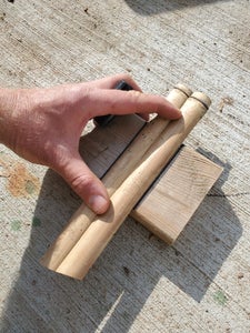

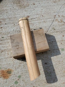

Pick something slightly larger than the width of your strap and scribe a line across the 2x4 chunks.
The width of the groove either doesn’t have to be exact, or this bamboo scrap was exactly the width I needed. Further testing will have to be done but my money's on not requiring exactness.

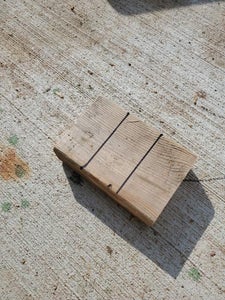

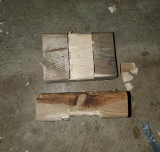

Chisel out the middle section. I suggest you cut stops at either side so you don’t accidentally chisel off the entire slab of 2x4. You can do this with the chisel but I used a bandsaw since it's way quicker.
You’re going to want to chisel the whole thing about ½’’ deep. Round the edges a bit to make it easier on the cam strap. Clean them up a bit with some sand paper.
A dado blade would probably make short work of this but I didn’t feel like finding mine and setting it up. Plus running a 5’’ block across a dado sounds like a recipe for missing fingers.
I suppose you could cut the strap grooves first then cut the blocks into 5’’ sections... but I digress…

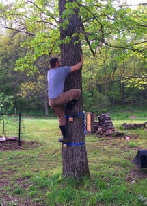

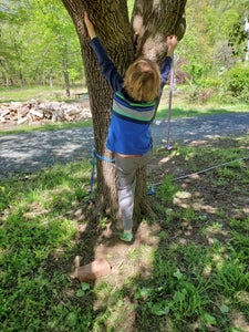

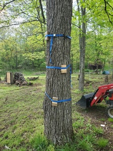

Wrap your cam buckle or ratchet strap around the tree you have chosen. Make sure it’s level around the tree then tighten the living snot out of it. Seriously tighten it, this is what keeps you from suddenly meeting the ground.
Start by setting them a little higher than knee high, then armpit, than high as you can reach. After that you either need to be content being 12' up in a tree or set them as you climb.
Is setting Tree Steps up as you climb safe you ask?

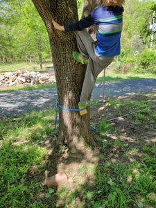

Magic 8 ball says “maybe?". But if you have a climbing belt to wrap around the tree and let you use both hands it’s not bad. Although in all honesty I don’t go too high in trees with any type of gear. Saying I dislike heights is like saying 14th Century peasants “disliked” the plague.
I will say these are probably way safer than free climbing a tree. Especially one with no branches. The amount of weight they are able to hold is quite impressive. I can stand on one and jump up and down on it (that is about 180lbs static weight plus whatever multiplier jumping has) So they're no slouch.
