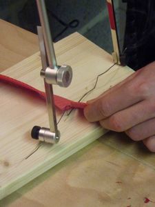

Step 2: Cutting the Straps
For cutting the straps you'll need the wood burner tool. Instead of using the pen of the tool which is to narrow to cut once threw the strap I bended a long and flat form out of a paperclip. Burning threw the strap also melts the loose particles together which is good because the strap will not ravel out.

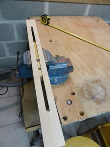

Step 5: Wooden Cylinders
Now cut two wooden cylinders of 28cm.
Then drill one hole 3cm from both ends. Optionally you can varnish the wood to protect it against rain.
