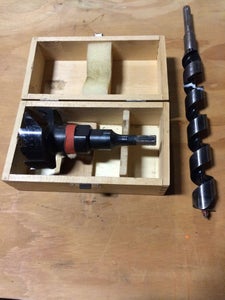

High Torque ( geared down drill ) - I prefer the Milwaukee brand Hole Hog Model
Auger Drill Bit ( appropriately sized to fit your tree bolt )
http://www.portlandbolt.com/technicalinformation/l... (use this link to understand the diameter of the pilot hole needed)
Self Feed Forstner Bit - I use also Milwaukee brand as they make them in all sizes

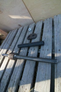

Tree Bolts or as they are referred to in the industry TAB ( Tree Attachment Bolts ) come in all shapes and sizes. They are based on a basic premise that load should be distributed into greater surface area at the moment or location where the bolt exits the tree.
The TAB consists of a boss or giant bushing affixed at the end of a bolt. Depending upon the context in which you plan to use the bolt you may have additional steel bar extending past the bushing on the outside of the tree. If you plan to use the TAB as a rigging point only then your bar needs to extend only a few inches past the pushing on the outside of the tree. I've pictured both types above.
Also pictured is a bracket that slips over the protruding end of the TAB. I call this a Bolt Hook. It is a simple laser cut bracket of 3/8" mild steel with a bit of a kink in it half way through. This hook is either used to rig directly off or can be used to rig a support cable that triangulates the cantilevered end of the TAB extension ( pictured ).

#2 - Install the Forstner Bit into the drill. Pull out the nail that was marking the location. Drill the depth of the hole shallow enough to ensure that the Boss on the TAB will protrude out of the tree enough to seal off any portion of the exposed interior of the tree. This is to ensure there is no space for infection or bugs to easily enter into and disturbe the critical nutrient flow layers just under the bark of the tree.
Step 6: Drill Auger Hole - Threads
#1 - (Leveling drill holes to each other is only necessary when installing TABs where the beam will be seated resting directly on the TAB.)
Attach the Auger drill bit in the drill. Using a Torpedo Level and a friend or two to check your drill trajectory for accuracy begin drilling the hole for the TAB threads. Accurately locate the center pin hole left behind from the Forstner bit with the tip of the Auger bit. Raise drill to a level position using the Torpedo Level directly on the Auger drill bit. Also make sure that your horizontal trajectory is to the angle you wish. Begin drilling, use a friend who can keep an eye on your drill bit as you drill to ensure it stays level. Check often using the Torpedo Level during this process as well until the Auger is to deep. There are ways to create jigs specific to your drill to ensure that your drill trajectory is perfectly level as you plunge the drill into the tree. Many professionals use rigs like this during this process to ensure accuracy.

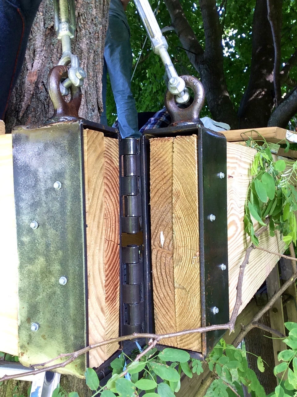

Once all of the bolts are completely installed, let the building begin! I've included two pictures which display different ways to triangulate the cantilevered end of your TAB should you be significantly loading the TAB. One of them reinforces the beam form the tip of the TAB and the other near the center with the beam loaded on the tip.
As my tabs are created from simple 1.25" all thread and a 4145 laithed bushing I needed to sheeth the treads where the beam would rest against the TAB all thread. I choose to do this because my bolting system allows for moement between the two bolts and there for the trees. The sheath that I used is a piece of pipe who's interior dimension ( ID ) matches nearly perfectly the outer dimension ( OD ) of my all thread. This sleeve sheath will protect the beam from digging into the all thread and allow for less friction in the system.
I was able to make this system dynamic and movable by fixing only one side of my beam to the bolt. This is illustrated in the pictures by the triangle plates. One plate has two holes where I've affixed the plate with bolts. The other side of the beam has a similar plate only on this side the plate has a long slot shaped hole. This long slot hole will allow this side of the beam to slide along the TAB and there fore allowing for movement in the system when the trees sway in the breeze.
