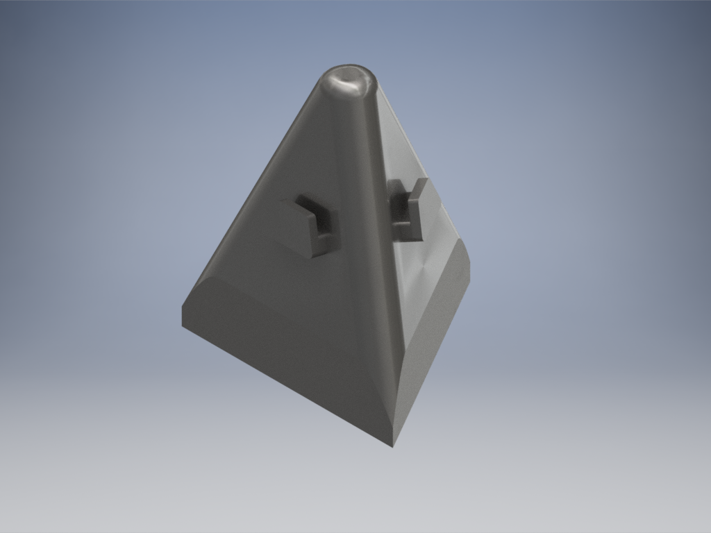

I decided to design and 3D print a finial for the top of the rods. The angles of the holes dictate the spread at the bottom. This version needed to fit in a pot so I set the angle accordingly. I also wanted something bright to add color to the teepee. Red was chosen but other colors (green, white, black, purple, etc.) are generally available at any 3D print shop. My local library offers the service and charges $.25/gram for the print. This part cost less than $4.00.
I’ve included the 3D print file (*.STL) in case others would like to print their own. I’ve also included the STEP file if you would like to modify the design to meet your requirements.

Step 2: Design Features
The design is based off a triangular pyramid with 1.5” long sides and 2” tall.
Step 3: Design Features
The 7/16” diameter holes in the bottom are at 8 degree angles and are .75” deep. For a 6’ long stake, this works out to an outer ring of 24.5”
Step 4: Design Features
In the finial 3D model, small upturned ‘L’ brackets were added to each of the three sides to attach string. This string runs down to the base and is attached by a cross string in two places. The peas will climb the string and the legs of the as they grow.
Step 5: Installation
Plant peas or pole beans in a pot or in the ground. Place 7/16” diameter stakes into finial holes. Place other end of the stakes in the dirt. Tie string across the bottom sides of the stakes. Run string across finial hook and attach to cross string as shown.
