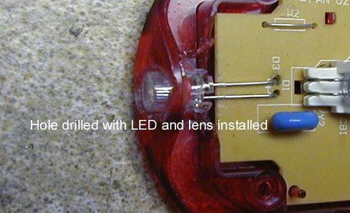

Step 3: Install the TRI Color LED With a 100 Ohm Resistor
This step may vary depending with the mod your are doing. I soldered a 100 OHM resistor inline with the + (the longer) lead on the 3 color led and since this is a USB mouse, connected the wires directly to the + and - connectors on the circuit board. I found that this peticular LED is sensitive to current requirments, to much resistance and all the colors won't light or cycle . Too little resistance an it will have a very short life !!. The measured voltage was aroung 5 vdc. Mount the LED in such a way that it will fit into the lens and give you the illumination effect you want.
Step 4: Case Mod the Mouse for the Clear Lens Led Holder.
For this applicationI I used a drill (about the same size as the clear led holder) and drilled the case for the Led lens. Without the case mod the colors of the led won't show hence the need for the led lens. A clear frosted base would be ideal, and you can use yor imagination for this mod.
Step 5: Test and Assemble the Mouse.
plug it into the usb port and make sure the led cycles through the colors.
Dress the wires away from mounting holes etc. and assemble the mouse.
