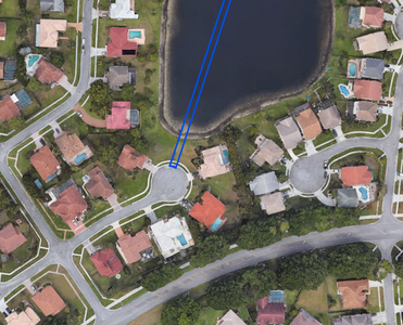

As I mentioned before, to get to my cousin's house I had to bike 3 miles (picture 1). One of the most dangerous aspects of this bike ride was a stretch of sidewalk (approx 0.5 mile) that was right next to a busy road where the speed limit was 45 mph, but drivers often exceeded this limit by 15mph+ since it was a long, straight road (picture 11). This meant that, as a 10-year-old, I was often riding my bike 3 feet away from traffic driving at highway speeds. As I start to think of it now, this was super dangerous, and frankly, this is one of my main motivators as to building this prototype.
With the community center, however, that 3-mile bike ride would actually be a much more reasonable 1.3 miles, almost 1/3 of the original distance (pictures 5-6). Additionally, this would let community members utilize much safer neighborhood roads with much less traffic going at much slower speeds (picture 12).

DISCLAIMER - The above photos DO NOT actually reveal my address nor my cousins'. I used estimated distances in relatively similar separations. However, this is still the same community area.

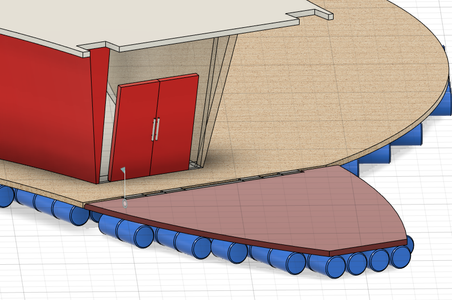

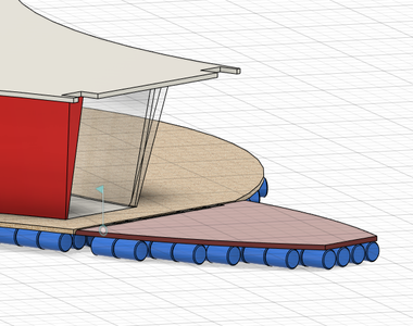

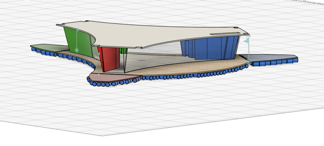

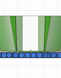

Before getting started with designing the building, I first took into account the community center's foundation which has to act as a giant floatie for the building. To figure out how many plastic 55-gal drums I need to make the building float I did some basic math and physics:

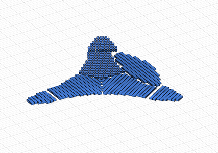

Given: Displacement / drum = 55 gals, Weight of water / gal ≈ 8.3 lbs (Source), Weight displaced per drum = ?
55 x 8.3 ≈ 455 lbs / Drum
This means that for every 55-gal drum I use 450lbs will be displaced. Now, I need to find out the approximate weight of the building to calculate the amount of drums needed:
Given: Weight / Ft^2 ≈ 200 lbs (Source), Building's Ft^2 = 5000, Building Weight = ?
200 x 5000 = 1000000 lbs = 500 tons (It's easier to keep in lbs for now)
Now I just need to find out the total amount of drums that I will need to use:
Given: Total Weight = 1000000 lbs, Weight displaced per drum = 450 lbs, Total Drum Count = ?
1000000 ÷ 450 ≈ 2250

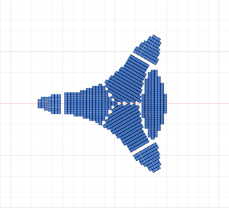

After laying out the drums, I found that I could place about 1125 drums right under the main floor of the buildings, this means that to fit the rest of the drums I will have to use two layers.
CAD

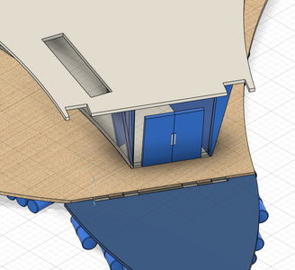

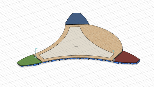

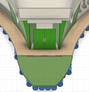

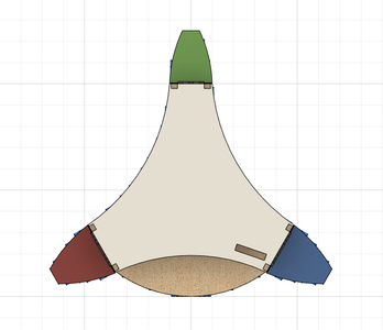

Before actually making these drums, I needed to make the main base so I would know how to place the drums, so before actually making these drums I first made the base layout. - To make these containers, I simply made 1:1 scale cylinders of the drums measuring about 3' x 2' in diameter. I didn't try to add too much detail to the containers since I knew that having so many detailed drums would probably overload my computer. After adding proper spaces for things like the hinges in the drawbridges, I added the plastic texture within Fusion360 so that I could later render the drums. To render the drums, I chose to render locally since it would take less time.
Step 6: Making the Base
Real World
Main Base
To create the base of the community center, a specific set of building techniques must be used. Since this flooring will come in contact with water, a waterproof and rot-resistant base needs to be installed. For this reason, I chose to use Fiberglass-reinforced panels (FRPs) which are water-resistant and do not deteriorate easily. Since FRPs cannot structurally support a lot of weight, the FRPs will just act as a base layer to protect the other vulnerable materials above. After this initial waterproofing from the FRPs, A plywood ribbing (See picture 11) will be used to make a hollow, but strong base. This ribbing creates a much stronger base compared to using regular plywood sheeting techniques.

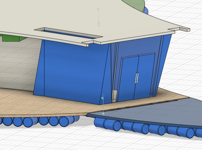

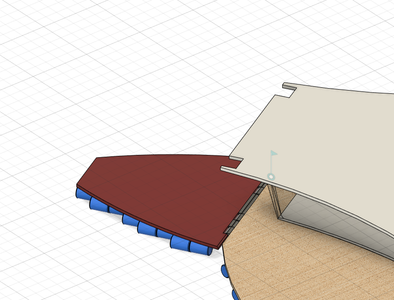

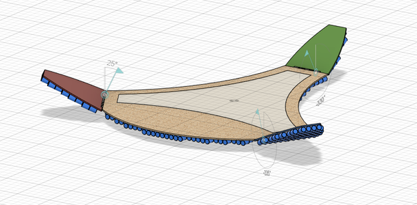

Drawbridge Hardware
To create the drawbridge feature, the hinge hardware has to be installed. This hardware is a two-piece system, the first piece of the metal hinge (you can see this in pictures 4 and 7) attaches to the main building base. After this installation, the drawbridge platforms can be moved into place with their respective hinge hardware. After both parts of the hinge are aligned, a stainless steel pin with grease nubs (similar to pins on excavators and cranes that connect hydraulic rams to the actual arm of the machinery) can be inserted. After the pin is inserted, the retaining pin is then inserted, and the main pin is greased so that the bridge moves with minimal friction. Since the actual drawbridge platform has drums, there is no need for a physical stopper because the bridge will start to float once it is in the lowered position. The rest of the bridge's hardware will be installed in later steps.
CAD
First off I started by creating a new file in F360. I chose to make design both the community center and the pontoon bridges in full 1:1 scale. To make the main base, I used the conceptual sketch as a reference to what I actually needed to sketch in F360. To copy the shape from my sketch, I first switched to the sketch environment. After entering the sketch environment, I started out by making a circle with a 100ft diameter. To get this number, I tried measuring various real-life objects to find a size I thought suitable for my community. I ended up going with the diameter of my neighborhood's culdesac which was about 100ft in diameter. After making the circle I then started to draw 3 lines from the circle's center to the outer edge, all 120 degrees from each other. These lines would represent the entrances of the building. After making these lines I then created 3 tangent lines with a 20ft span. I then used the constraints to constrain the center of these lines to the ends of the other previous lines. I then made these lines tangent to the circle. After doing this, I then created three arcs that connected the ends of each tangent line. This formed the "tri-pointed" shape that I was looking for. After making these points. I then made another arc to form the deck area at the front portion of the building. I then switched back to the 3D modeling environment. Since this CAD model was for rendering purposes, I didn't make the internal ribbing in the base (since this wouldn't be visible) and I just extruded the shape to the designated thickness. After making the main base, I then moved on to make the drawbridge hardware and their platforms. To make the bridge's hardware, I made simple hinges by creating a mounting plate (Picture 11) and then added a cavity for the connecting pin. I made sure to add chamfers to the edges so that the pin could be easily installed. Then, I started to make the bases of the drawbridges. To make the bases, I started with a 20ft line and an 8ft line with a perpendicular line separating these two lines by 20ft. I then connected the ends of the 20ft and 8ft lines. The reason for the 8ft span at the exiting end of the drawbridge was to make the construction of the pontoon bridges simpler by making the width the same as a 4ftx8ft sheet of plywood. After making the hardware and the bases for one drawbridge I just used the circular pattern tool to copy and paste them for the other bridges. Since I was starting to make a lot of different assemblies, I started to organize all parts into different components and assemblies. I made sure that the drawbridges and the main base were different assemblies so I could create joints between the assemblies. To make the joints, I used the connecting pin as the reference point and I then added a 30-degree stop.

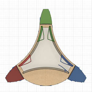

Step 7: Adding Walls and Ensuring Structural Integrity
Real World
Colored Walls

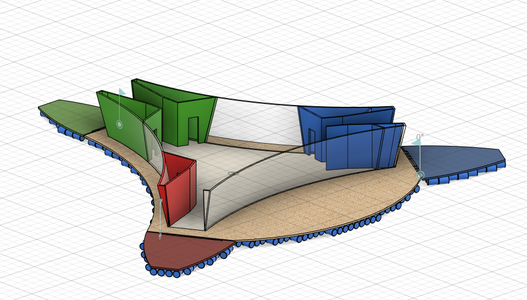

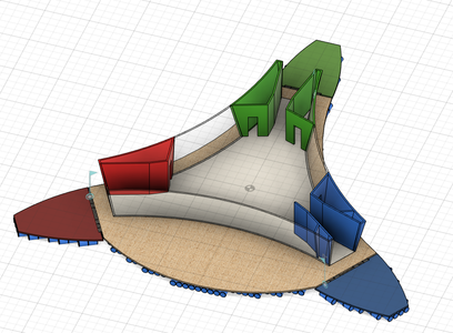

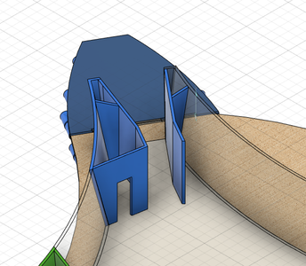

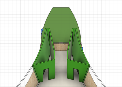

Instead of relying on pillars to support the roof, triFusion relies on the exterior walls and the interior weight-bearing walls to support the roof. Since the structure will naturally rely on the walls to support itself, the walls will have to be extremely tough and rugged because it will reside in South Florida, a hurricane-prone area. For this reason, the community center's walls must conform to the extremely strict Florida building codes. As per the 2017 FBC Building Code 1604.3, exterior wall deflection due to hurricane-force winds shall not exceed 1/360 ft (Pictures 7-8). To comply with this code, the best course of action is to utilize a mix of cinder blocks and cement to create the colored walls (R, G, B). The walls will be constructed on top of the base, using rebar anchors to anchor the wall to the base. In addition to the rebar anchors, cement will be laid down underneath the walls, inside the base so that the walls are weighed down. In regards to supporting the roof, the cement and cinder blocks will allow for great compression strength while the rebar will keep the walls from cracking under tensile forces that occur when the concrete expands due to heat (this cracking is a major problem in Florida due to the extremely high heats year-round). Finally, anchors will be installed on these cinder block walls so that the glass walls can be installed.
Glass Walls

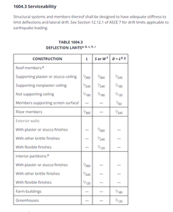

As I previously mentioned, all the exterior walls in the building must not exceed 1/360ft deflection due to hurricane-force winds as per the FBC Building Code. This means that the glass walls in this building must be hurricane-proof to pass this requirement. To reinforce the glass walls, a structural support framework will be integrated. This framework will be made of robust, corrosion-resistant materials such as stainless steel. It will provide stability and distribute the load evenly across the glass panels, minimizing the risk of excessive deflection during hurricane-force winds. The glass panels will be securely anchored to the colored walls using a combination of mechanical fasteners and structural silicone sealants. The mechanical fasteners, typically made of stainless steel, will provide additional support by firmly attaching the glass to the framework and preventing any displacement.
CAD

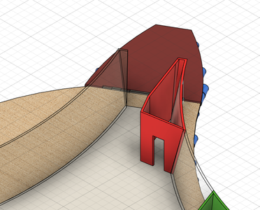

To make the colored walls, I started by making a new sketch and going back into the sketch environment. I start out by projecting the internal flooring so that I can tell where the walls will need to go. After projecting the floor, I start by offsetting the outside perimeter of the flooring by 8" so that the outside walls will be formed. Now that I've completed the sketch for the bottom part of the wall, I have to create a slightly offset top sketch that will for the curved wall (see pictures 9-10). To create this offset, I first create a new plane that is 15ft offset from the floor (this is to make sure that the sketch is at the top portion of the wall), then I project the same sketch that I created previously, finally, I offset this whole sketch by about 1ft. To connect these two sketches, I use the loft tool which connects these two sketches. After creating this colored, outside wall, I then mirror it so that both of the colored walls for one tip of the building are created. Then, I select these two components and use the circular pattern tool to create the remaining colored walls. After doing this, I use the same process to create the glass walls, making sure that the same height offset is used so that the wall curvature is uniform. Finally, I created the interior walls by creating another sketch and drawing the individual interior walls for the entire building. In this case, I did not use the "lofting" technique since the interior walls were meant to be straight, so I just used the extrude tool to create the walls.
Credits: Picture 8

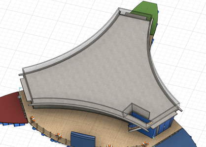

In a similar process to the base, the roof is constructed of a wood shell with internal ribbing to enhance its strength. However, in this case, the roof would be filled with insulating foam since heat can seep in much more easily than it could compared to the base. This foam will help keep the building cool during the season-wide sunny days in Flordia. In the actual construction of the building, the whole roof would be assembled, and then a crane would hoist the roof into place. However, before the roof is hoisted into place, mounting brackets would be installed on the roof, and more rebar would be left exposed on the exterior walls and the interior weight-bearing walls. As the roof is hoisted into place, workers would align these mounting brackets on the roof to the rebar on the walls. Once the roof is aligned, workers would weld these mounting brackets to rebar to create a strong and secure joint. Finally, after the roof is connected, silicone sealants would be used to make sure there is an air-tight seal between the roof and adjacent walls.
CAD
To make the roof, I created another new sketch and switched back over to the sketch environment. I then projected the outer perimeter of the exterior walls. I then offset this projection by 2ft so that there would be a slight overhang allowing for more shade and coverage on the outer deck of the building. I then extruded this sketch to create the actual roof component. Then, I went back to the sketch environment and made sure to add a cavity in the roof so that the stairs to the upper deck could pass through and up to the deck. Finally, I made another sketch that covered the areas where the main support pillars for the drawbridge were to be located and then I extruded this sketch and used the circular pattern tool to repeat the same process on each drawbridge section.

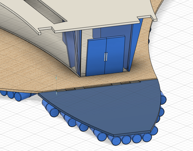

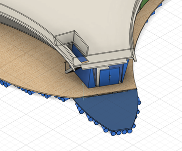

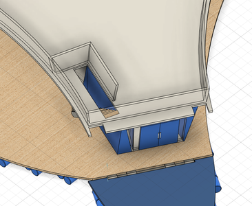

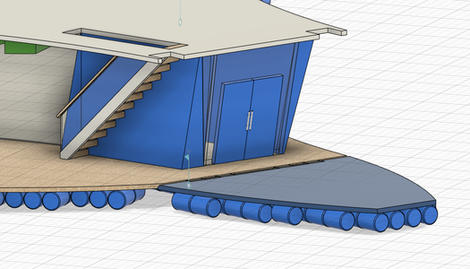

To add the entrances, a surround glass fixture is installed on each entrance of the building so that the doors can be installed. After these fixtures are added, the door hardware is assembled and installed along the outer edge of the glass fixture. In addition to the basic doors, an all-weather rubber strip sealant (similar to the rubber that is used in car doors) is installed to make the building waterproof and to keep the building insulated. Keeping in mind the FDC building code, all doors comply with the Americans with Disabilities Act (ADA) featuring the following: opening widths of 32in, easy-to-grasp handles located 48in from the ground, and electrically operated door openers with opening switches within 32in of the ground.
CAD
To make the entrances, I focused on mainly making one entrance and then using the circular pattern tool to copy and paste the whole assembly to each entrance. To begin, I first made the surround glass fixture by going into the sketch environment and creating a new sketch. Since this glass fixture is technically considered an exterior wall, I followed my previous technique to add a slight curve to the wall which was to first draw the sketch of the bottom portion of the wall and then offset that sketch by 1ft to create the top sketch. To join these sketches together, I used the lofting tool. After creating the actual wall, I then created another sketch that outlined where the doors would go on the wall. After making this sketch, I then extruded it to create the cavity where the doors would go. Using this same sketch I then extruded the doors. Finally, I made the handles by creating two cylinders and then connecting those two cylinders with another longer cylinder. (ADA compliance hardware will be added throughout the utilities and electrical steps later in the instructable)

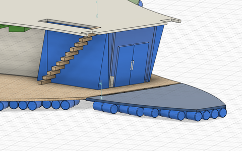

Before adding the railing on the upper deck, the stairs must be added. To install the stairs, a hollow wall must first be installed. This wall is not meant to be a retaining wall so it is made out of the same plywood shell and ribbing techniques as the roof and the base. After this wall is installed, wood risers are then installed at 7in intervals in the Z axis and each riser is 11in deep, all in accordance with the FBC Building code (504.2 Treads and Risers). After the risers are installed, the stair's wood and glass railing is installed along with the sideboard. Now, the upper deck railing can be installed. Since the railing will be made out of glass, the same hurricane-proof glass panels from the building's walls will be utilized. This railing will be made up of 3 pieces, one piece for every side of the building. These pieces will be assembled using the same anchors and rubber sealants as the glass walls that were previously constructed.
CAD
I started by creating another sketch and switching back to the sketch environment. First, I started out by outlining the retaining wall for the staircase. I then extruded this wall out to the roof's height. After extruding the wall, I then used the existing wall's surface to split the extruded wall into the final shape. Next, I created another sketch on the wall's surface and started to outline the riser's dimensions, I then used the rectangular pattern tool to ensure a constant separation for both the tread depths and riser heights. Finally, I created the sideboard that would connect all the risers on the other end of the staircase and created the glass railing with wood handles. Since the upper deck railing would have the same shape as the exterior walls, I simply copy and pasted the lower walls and used the scaled tool to shorten the railing to an appropriate height. Finally, I added a surrounding railing around the hole where the staircase passed through to make sure that no one fell through.

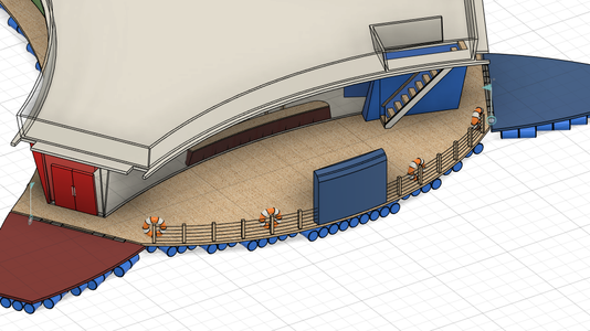

Step 11: Lower Deck Railings and Safety
Real World

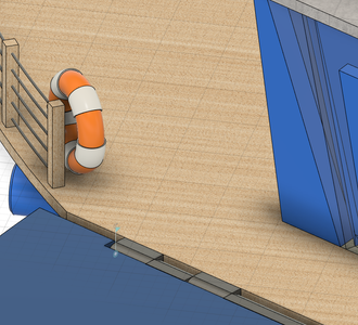

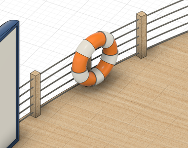

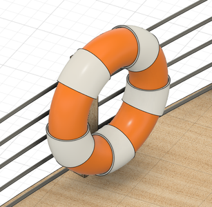

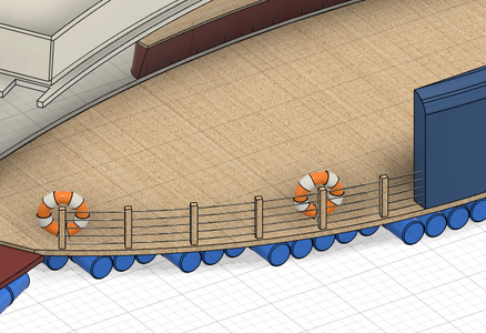

To make the deck safe, railings and life preservers must be installed. The deck railing will be made out of pressure treated, 6inx6in timbers and 1in steel cables. Before installation is started, 5 1-in diameter holes must be drilled into every timber so that the railing's cables can be installed. After drilling these holes, the timbers are then installed. To install the railings, the wood timbers are installed at 4ft intervals around the perimeter of the deck (except the center of the deck where the outdoor theatre projector screen will be installed). Once the timbers are installed, the cables are threaded through each timber and then secured at each end of the railing. Once these railings are installed on the front deck, 4 life preservers are installed at 25ft intervals. Since the decking that connects the blue section to the green and the green to the red should not be accessible to community members, railings will not be installed, however, gates will be installed to prevent community members from accessing this area and to give access to maintenance members.
CAD
To create the railings, I first start out by creating a new sketch. The first thing I do is to offset the perimeter of the decking by about 1/2ft, this provides the center line for the railing. I then create the first 6inx6in timber outline at the center of the deck so that I can use the circular pattern feature to create many timbers at once. I then delete the irrelevant timber outlines including the timbers that are located where the outdoor theatre screen will go. I then go into the 3D environment where I extrude these timbers 36in. After doing this I create another new sketch on the surface of the first timber in the railing. On this timber, I create 5 equally spaced 1in circles. I then switch back to the 3D environment and use the sweep tool to extrude these cables along the railing's centerline. Finally, I add the 4 lifer preservers and the holders onto the timbers, making sure that they are all 25ft apart.

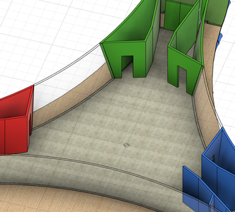

Step 13: Interior Space and Floor Plans
Before starting to design the interior, I first made sure that I planned out what each area was going to be. I started out by defining what the blue area's rooms were going to house. The upper room will house the pantry, refrigerator, kitchen equipment, and tableware. The blue area's lower room will house the bathroom. This bathroom will follow ADA requirements and feature a baby changing area. Located at the center of the blue area will be the island with cooktops, a seating area, and a rear countertop bench. Moving on to the green area, the upper room will house all the AC and HVAC utilities followed by the lower room that will house the electrical and water utilities. Located at the center of the green area are the planters and water tanks. Finally, the red area will house the 3D print farm on the left side wall, the tech and drafting desks in the rear desk area, and all the art supplies at the various tabletops.

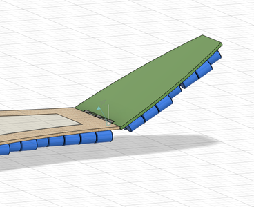

Step 22: Draw Bridge Utilities
Real World
Installation

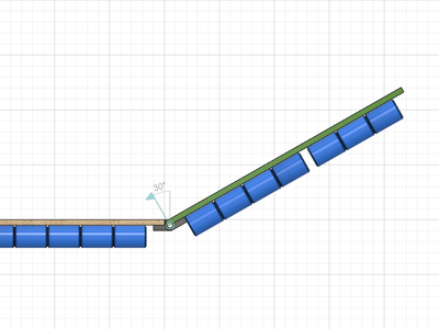

To install the drawbridge utilities, the main mechanical components must be installed. First, counterweight arches are installed on each drawbridge so that counterweights and motors can be installed. Within these arches, counterweights are installed that balance out the weight of the bridge itself. This counterweight enables the drawbridge's motors to move the bridge without actually having to lift the bridge, all the motors will have to do is move the cable slightly and the counterweight and gravity will do the rest of the work. After the counterweights, arches, and motors are installed, the steel cables connecting the counterweights to the bridge are installed on the anchor points on the bridge. Finally, electronics and wiring are run through the base of the building, connecting the drawbridge to the control panel in the utility room.
Math and Physics
The main Physics problem in creating the drawbridge is how much should the counterweight weigh to make the motor's work as easy as possible. The main Physics principle used to calculate this weight is Rotational Kinematics - Equilibrium of Rigid Bodies (Torques). Before starting to explain the actual scenario, I drew up a moc scenario describing the problem at hand (third image).
  • First, the drawbridge platform's weight must be calculated:
Using the previous estimate of 200lbs/Ft^2 (mentioned when creating the barrel base), we can calculate the weight
Mass:200 x 500 = 100,000 lbs = 50T
Weight = Mass x Acceleration due to Gravity (g)
W = 50T x 10 m/s^2
W = -500N
  • Next, we must find the tension force to balance out the -500N
As I described in the moc scenario, the angle that the cable makes with the bridge is approximately 45 degrees.
θ = 45 degrees
Vertical component tension force needed = +500N
X = Tension Force / Weight of Counterweight
Xsin(θ) = +500N
Xsin(45) = +500N
X = +500N / sin(45)
X = 707.11N
  • Now that we know the counterweight weighs 707.11N, all we need to do is deduce the actual mass of the counterweight.
M = Counterweight Mass
707.11 = M x 10 m/s^2
M = 707.11 / 10 m/s^2
M =70.711T
So now we know that the counterweight for the bridge must be roughly 70T for the bridge to maintain perfect rotational equilibrium.
CAD

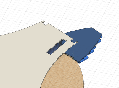

Since the whole drawbridge assembly was already made in previous steps, I will focus on the actual mechanical components of the drawbridge. I started out by making the counterweights and counterweight arches. To make the counterweight arches, I created a new plane to create the profile of the arch, then I made an offset of the profile to create the hollow void where the counterweight would reside, and finally, I extruded the arch and then mirrored the body to the other side. To make the counterweights, I used the hollow void as a starting point and then used the offset tool to make the counterweight slightly smaller than the void (to allow for smooth movement). Finally, I ended by creating the steel cables that connected the counterweights to the anchors on the drawbridge. To make the cables I made a path and then perpendicular to the path I created a circle sketch. Then, I used the sweep tool to sweep the sketch across the path, making the two cables.

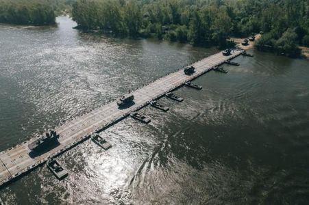

Step 23: Inspiration and Ideas
Now that I've already designed the community building, it's time to connect it to the land. To do this, I chose to use pontoon-style rafts that connect together to form one large, flexible bridge. The main inspiration behind this idea is actually the U.S. Army's improved ribbon bridges or IRBs, which utilize small connected sections of pontoon rafts with road platforms to make one large bridge that tanks and other military vehicles can use to cross bodies of water. I chose this style of bridge mainly because it is highly maneuverable and can easily be disassembled and moved to another location. Additionally, since the bridge can be built in portions on land, community members can collectively help to build the bridge, allowing the community to feel a sense of accomplishment and also allowing them to add personal, custom additions to the bridges (decorations).
Image Credits:
Image 1 - U.S. Dept. of Defense and Image 2 - U.S. Army

Now that we know the final weight of each bridge section, we need to calculate how many drums are needed to support each of the bridge sections.
Drums Needed
  • 5,857 / 455 ≈ 13 Drums
With the weight of the raft being about 5,750 lbs, we would need 13 drums, however, this does not take into account the weight of the pedestrian traffic that will use the bridges. So, to be sure the bridges can handle their own weight and the weight of pedestrian traffic, 16 Drums will be used to allow for a max weight of about 7,250 lbs.
CAD
To make the rafts, I just copy and pasted over one of the drums from the base of the community center. I then used the square pattern tool to create a 4x4 grid of 55 gal drums.

Step 26: Decking and Railings
Real World
Now that the 55 gal drums are set in the 4x4 configuration, the plywood base and decking can be installed along with the railings. First, the plywood base has to be installed. Since the dimensions of the bridge section are 12 Ft x 8 Ft, the plywood platform can be perfectly made out of 3, 4 Ft x 8 Ft plywood boards, without having to make any cuts or adjustments. Since the base of the community center is made using the shell and ribbing technique, the base of the bridge sections will have to be thicker so that both the bridges and the building are at the same level. To adjust the height of the bridge's deck, more plywood sheets can simply be added to compensate for the delta in height. After installing the base, the 2 in x 4 in decking can be installed perpendicular to the 12 Ft side of the bridge section. Finally, the 6 in x 6 in railing posts can be installed and then holes can be drilled so that the steel cables can be run.
CAD
I started out by making the base of the actual bridge section. To do this I just made a simple rectangular sketch and extruded it to the same height as the community center. I then created the six railing posts by making a rectangular pattern of 6in x 6in squares. After extruding the squares, I then added the 5 holes to each post so that the steel cables can be run inside of the posts. I ended by extruding all the steel cables that would make up the railing.
MAYA
To keep the same style as the community center, I used the same wood and steel textures for the railings. However, the decking texture for the deck of the bridge was changed to the 2x4 style decking. I then rendered out all the images using a variety of different focal lenses and image sizes, however, all renders were rendered at 1000 samples.
