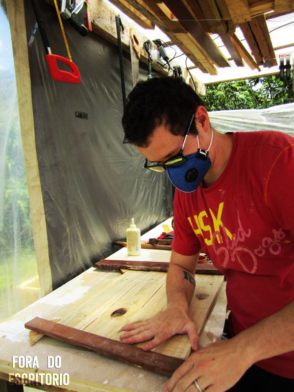

Step 6: Back
For the back, lay a few pieces under the bigger triangle and trace the out line of it on to the boards.
Fasten it with glue and screws.
Step 7: Glue Smaller Triangle
Now you can measure and center your smaller triangle. Use glue to fasten it to the back panel. If you want you can screw it from the back as well.
