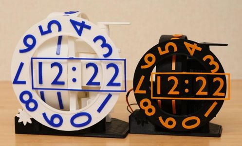

The 3d printed Triaxial Numechron clock by Shiura is a wonderful and unique timepiece, which is easy to print & assemble and fascinating to watch.
However, it has two issues.
The original Arduino electronics do not keep accurate time, as the Arduino Nano used, does not have an accurate crystal oscillator.
The second is the stepper motor. It is very cheap and was never designed for accurate positioning. They are made by various different companies, which causes variations' within them.
The stepper-motor has 32 steps per revolution, fed through a gearbox with a nominal 1:64 reduction. Thus 2048 steps for one full rotation. However, it has been found that the the gearbox on some units is actually 1:63.682...... thus it can never position the minute dial accurately and slowly fall behind, misaligning the minute digits.
Note on my test unit, the motor was exactly 1:64 and when left running for six hours, it was found the digits were still correctly aligned.
The test code (detailed later on), will allow you to run the stepper and the clock, to see how accurate your individual stepper motor is.
So my aim was to design new electronics to correct these issues. The design brief should:-
1) New electronics should be simple, so those with limited electronics or Arduino (microcontroller) experience can build the upgrade without any more skill than that required for the original Arduino electronics.
2) The retrofit should not require modifications to, or re-printing of clock parts.
The original stepper motor is retained and the optional Hall sensor is mounted using an additional 3d printed bracket, which mounts using the existing stepper-motor mounting holes. Thus no new clock parts, or modification to it, is required.
