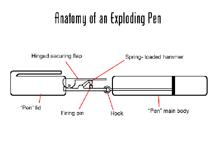

Exploding pens are a practical joke. While on the outside they may look like pens, inside they contain a spring loaded mechanism which is attached to the main body of the pen by a hook and which fits into the cap of the pen. To arm the mechanism, the spring-loaded hammer is pulled back and an exploding cap placed onto the firing pin. The hinged flap is the folded back down over the pulled-back hammer, and the device slotted into the lid of the pen. When the lid is removed the hammer is free to spring back into place, firing the cap and creating a loud bang.

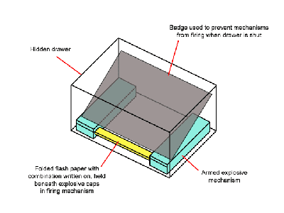

Setting up the exploding mechanism proved quite tricky, so here are some tips which will hopefully make the process as simple as possible.
Firstly, the flash paper. You only need a little bit - having too much makes attaching it to the firing mechanisms more difficult and increases the likelihood that the cap will fail to ignite it. Write the combination as small as you can, and then use scissors to trim off as much excess flash paper as possible. Also, write the combination in pencil rather than pen - the flash paper is slightly translucent and ink marks from a pen would be visible though it, so a devious victim might attempt to solve the combination by reading it through the flash paper.
When placing the flash paper into the firing mechanisms, make sure that you place it directly onto the pin and then put the exploding cap over the paper; otherwise the paper will not ignite. This is another reason to use as small a piece of paper as possible.
Arming the mechanisms was fiddly as hell. I set up the paper and the caps as described above, then placed them all together into the bill box's secret drawer. The bill box is deeper than the armed mechanisms are tall, so you'll need to place something on top of the mechanisms otherwise they'll fire prematurely. Thankfully the skull-and-crossbones badge I'd bought as part of the gift came attached to a piece of card, so I used that.
So, the two unarmed mechanisms and the flash paper were placed into the secret drawer, and then exploding caps were placed onto the firing pins on top of the flash paper. At that point I armed the first mechanism, pulling back the hammer and folding the hinged arm down to cover it. I then armed the second mechanism, using my little finger to hold down the hinged flap of the first and prevent it from firing. When both mechanisms were armed I placed the badge into the drawer on top of them, still holding it down to prevent firing, before sliding the drawer shut.
With the drawer shut the badge was held in place, preventing the pins from firing, but I know from experimentation that if the drawer were opened the mechanisms would have fired. You'll have to do a bit of experimentation yourself to find something suitable to hold the mechanisms down.
