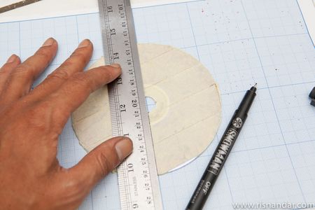

Step 3: Tricopter Frame
To build the center frame (top and bottom), i use 'Milimeter Block' book to make straight lines.
- First, use paper tape to cover the CD so we can draw some lines using small Permanen Marker
- With Milimeter Block book as background, center the CD then draw lines from top to bottom (use top and bottom lines on MBlock book)
- Next step is make diagonal lines on the left, still use the Milimeter Block background as reference
- Same with diagonal lines on the right, use the Milimeter Block again
- When 'Y' lines is completed, drill 2 hole 3mm for each arm, we will attach the acrylic with bolt and standoff aluminium
