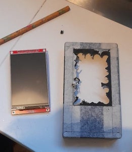

Step 1: Hardware Build
The project can be built into any suitable box. The parts list contains a link to a suitable sized project box.
A milling machine with digital readout is the ideal way to cut the hole for the screen and drill the hole for the buttons. However it is easily accomplished with basic hand tools, by covering the box lid with masking tape & drawing the cut lines & drill holes.
The encoder requires a 6mm drill bit & the buttons, a 13mm drill bit. Brad point bits are ideal for drilling plastic with a hand-held power drill, as they will not wander. Links to suitable cheap drill bits are given in the parts list.
If using a pillar drill & clamping the box, then metal cutting drill bits will work fine.
The square screen hole can be cut by first drilling a series of overlapping holes, inside the cut lines, to remove the bulk of the material.
Carefully score the outline with a Stanley knife (box cutter) using a metal straight edge that keeps your fingers well away from the blade. A plasterers trowel works great. Take your time, slowly getting deeper with each cut. Using a hacksaw, cut diagonally into each corner of the rectangular cut-out. Using pliers, it should now be possible to bend the waste material inwards and it should break along the score lines. If it will not easily bend, continue scoring. The cut edge can then be cleaned up by scraping with the knife and a file.
More details & pictures are in the Hardware Build document.
