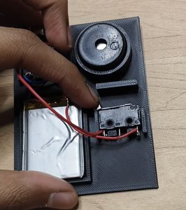

Step 2: Assemble With the 3D Printed Parts
Assemble the circuit as shown in the image.
Use the holder.stl part.
I used 3M double tape for TP4056 and Lipo battery.
  1. I used Hot Glue for the Limit Switch
  2. NOTE: For the buzzer, i have used mine which is exactly fitting in the design. Make sure your buzzer is 25mm or less than that.
  3. In the case of a smaller buzzer, just Hot Glue it to the side of the cylindrical shape.
Refer to the video for a better view.

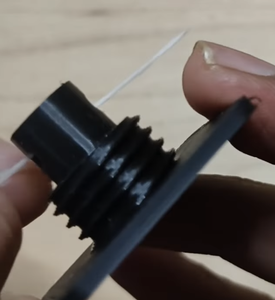

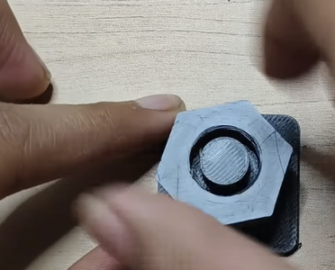

Step 3: Assemble String With the Base
Dental floss is perfect for this application as its strong and also easily available.
You will need the following 3D PRINTED PARTS:
  1. string_tightener_base.stl
  2. string_tightener_nut.stl
Pull required amount of string/dental floss. Make sure it is a bit longer than your door length or walkway length.
  1. Insert the string into the hole of the string_tightener_base.stl part.
  2. Next, screw the string_tightener_nut.stl onto the string_tightener_base.stl part.
  3. This ensures the string is tight and wont come off.

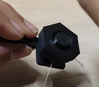

Step 4: Assemble the Trigger Mechanism
This step is the same as the previous step:
  1. Insert the other end of the string into the hole of the trigger.stl part.
  2. Next, screw it using the string_tightener_nut.stl part.

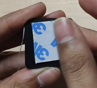

Step 7: Setting Up the Alarm
Best preferred to set it up in the entrance of a room.
So, I then used 3M double sided tape on the back of the string_tightener_base.stl part as shown in the image.
Now stick them on the doorway borders.
NOTE: you can adjust the tightness of the string by unscrewing pulling how much ever you want and screwing it back.
