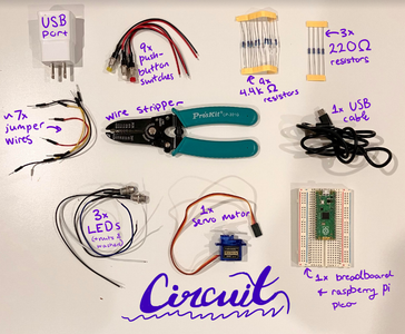

Materials:
Circuit:
- ~7x jumper wires (male-male)
- 1x servo motor
- 9x push buttons (+ their nuts & washers)
- 1x breadboard
- 1x Raspberry Pi Pico
- 3x LEDs
- 3x 220 ohm resistors
- 9x 4.4k ohm resistors
- USB cord + block
Construction:
- 1x box (should be large enough to hold the circuit + drill buttons)
- 2x straws
- 1x mini pie tin
- shaving cream/whipped cream
- paper
- colored pencils/pens (optional)
Tools:
- Scissors/Exacto knife
- Tape
- Hot glue
- Wire stripper
You should also have Thonny installed in your computer for this project, and have a power outlet nearby to plug your raspberry pi pico into.

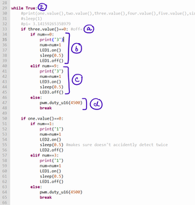

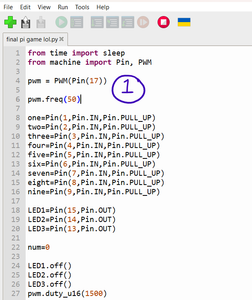

For this project, we'll be coding using Thonny, through the Raspberry Pi pico interpreter. The link to the code is attached below this step, but here's a brief explanation of what it's doing (the numbers on the image correlate to the explanations):
1) Imports + Pin setups:
For this code, we'll be using PWM (Pulse Width Modulation), which is useful for controlling the amount of power delivered to a load or the output. Since we're also importing Pin, it means we refer to the pins while setting up by their GPIO number rather than pin (board) number.
Values for the LED's (the output) and the push-buttons (input) are also assigned and given names here. By using 'Pin.PULL_UP' for the push-buttons, there's also a default of a 'high' value, or 1.
2) While True loop:
**This explanation is only for one if statement, although there are many in the overall code**
Each of these if statements follow the same basic structure, and code for the varying outputs for a given input.
a) If the value of button 3 is 0, it means that the button was pressed. If this condition is met, then it checks for the statements within it.
b &c) The variable 'num' counts the number of digits pressed (ex. 3 is the first digit, so num=0, for 1, num=1, for 4, num=2, ect.) Using that, the code checks to see if the buttons were pressed in the correct order. For the example of 3, it would be pressed on the first and tenth digit, or when n=0 and n=9. If this condition is fulfilled, then 1 is added to num, because another digit is added to the sequence. An LED also lights up to tell the player they got it correct, and it also serves to temporarily stop the button from inputting values, to make sure it does not accidently detect the push twice.
d) The else statement basically tells the code what to do if neither the if or elif statements above (b&c) are met. In this case, it triggers the servo to turn a little over 90 degrees, and then breaks out of the code to prevent the while true loop from repeating.
Later in the code, there's also a light sequence that starts if the player reaches the 15th digit of pi! Also, make sure to save this code as 'main.py' so it can run remotely when connected to a power outlet.

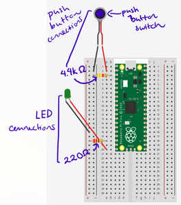

Step 2: Circuit
LEDs-- connect the positive end of the LED to the corresponding GPIO pin (refer to the code & pinout chart above), and the negative end to a 220 ohm resistor, and through that to the negative end. One example LED connection is shown in the image above.
Buttons-- similar to the LED connections, but use a 4.4k ohm resistor for each one. For testing, I also labeled each button with the corresponding number to keep it organized.
Servo motor-- connect the VCC, GND & Signal Pin to the 3.3V, GND & GP17 pin of the pico.
