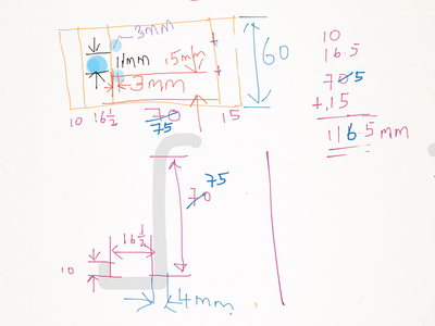

Step 1: Profile of the Acrylic Frame
The draft not up to scale uses about 120mm of acrylic board (a.k.a. plexiglass) of 4mm thick.
Videos shown how to bend acrylic it into shape using home made acrylic bender.

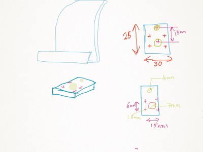

It also show the four holes made for mounting screw (2mm by 7mm long).
A 7mm hole made for thread tapping the 3/8 inch tripod bush nut.
The YouTube video guide should be able to provide an idea how thing was done.
