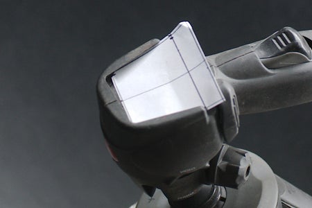

Getting the dimensions and shape:
Approximate the dimensions and shape of the plate by sliding a thin paper into the tripod slot and marking the size. Adjust the size of the paper using scissors until it reaches the final dimensions. (pic 4).
Making the Lower piece:
Now cut a piece of hylam sheet in the required shape based on this piece. This will be our lower hylam piece. I fixed the paper on the sheet and cut it with a small saw. (Cut it slightly bigger so that we can file it down to required size.) Adjust the shape and dimensions by repeatedly filing and trying to fit the piece in the slot, until it slides in effortlessly. Please note that there should be no play, and the piece should fit snugly. Now drill a bigger hole at the center. The hole should be sufficient to let the head of camera mount screw pass through it. (So that the screw gets flush with the base of sheet, and can be slided into the tripod slot.) The other two holes are for bonding the two pieces together.
