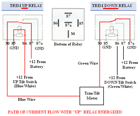

IMPORTANT: The engine outdrive trim tilt pump motor will work only if BOTH relays are connected. This is because power to the trim-tilt pump motor is in series with BOTH relays. The direction that the pump runs is determined by the direction of the current flow through the relays. This can be confusing to troubleshoot because there are a total of 10 terminals involved. When you activate either relay by pressing the tilt switch up or down, the internal solenoid winding becomes energized (you should hear the relay click) and the series ground contact is broken and toggled over to a 12 volt input (terminal 87 - the thick red wire). (See diagrams)
Wire jumper configuration to completely bypass the relays and make the motor trim UP:
On the UP relay, place a jumper between terminals 87 and 30
On the DOWN relay place a jumper between terminals 87A and 30
Wire jumper configuration to completely bypass the relays and make the motor trim DOWN:
On the up relay place a jumper between terminals 87A and 30
On the down relay play a jumper between terminals 87 and 30
When replacing relays, always replace both at the same time. If you have installed new relays and the trim/tilt pump motor still won't run, there is obviously a problem with the wiring from the sockets at the base of the relays. Remember this: CORROSION between the male relay terminals and the female relay terminal socket is the biggest problem. CORROSION inside the quick disconnect plugs is also highly suspect.
To test the motor itself, bypassing the relays and relay wiring, find the two heavy gauge wires that lead to the trim/tilt pump motor. One should be green and the other blue. You will probably be able to find a quick disconnect plug near where the wires exit the outboard engine cover that you can disconnect. Ground one wire to any metal surface and provide +12 volts from the battery to the other. The motor should run in one direction or the other. Now reverse the wires and the motor should run in the other direction. This will at least tell you if the motor is operating, so that you will have a better idea of what the actual problem might be. You can also pull out a relay (one at a time) and place a temporary wire jumper inside the relay socket across terminal 87 (the +12DC input voltage source) and terminal 30 (the outgoing wire to the trim/tilt pump motor) to make the motor run. It is worth repeating here: The voltage and current flows through BOTH relays, therefore when testing be sure you have a complete circuit.

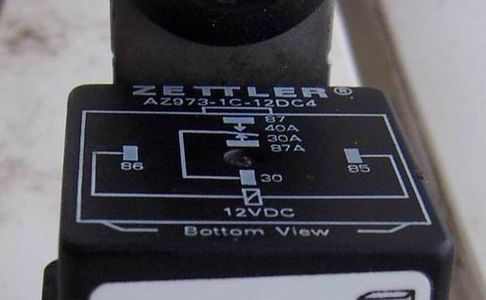

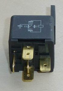

Several different 12VDC SPDT relay models will work as long as there are 5 terminals.
Mercury Marine Trim Tab Relays:
- Hella 12V 4RD 960 388-01 SPDT relay (cube shaped relay without bracket)
- HL87411 (waterproof relay with bracket)
- Quicksilver 882751A1 (waterproof relay with bracket)
- Zettler AZ973-1C-12DC4 (waterproof relay with bracket)
