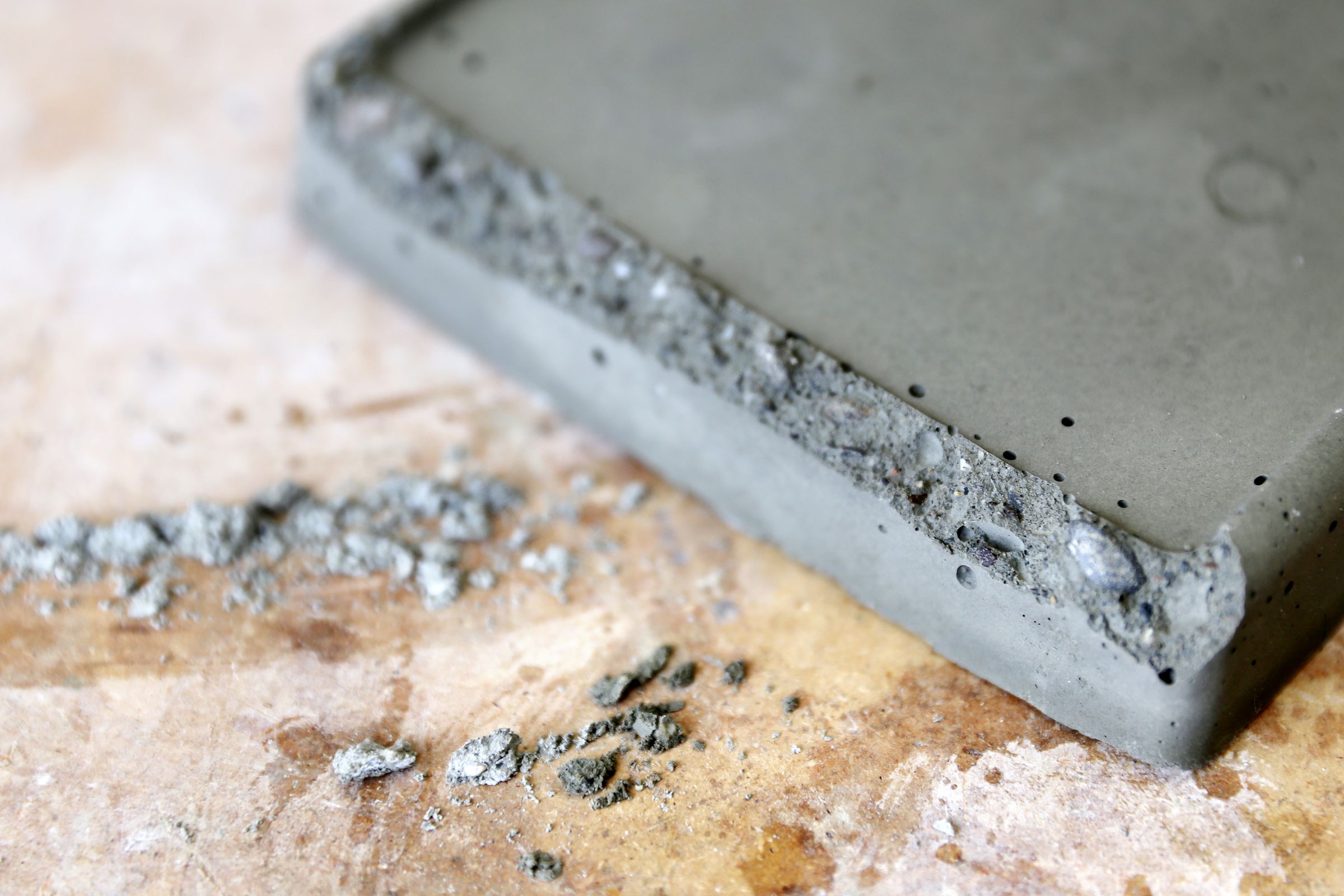

Concrete Crumbly When Cured
This sometimes happens when you remove the concrete from the mold before it has completely cured, or if your water to cement ratio was too dry or too watery. See the Mixing and Pouring Concrete Lesson for tips on how to mix concrete perfectly every time.

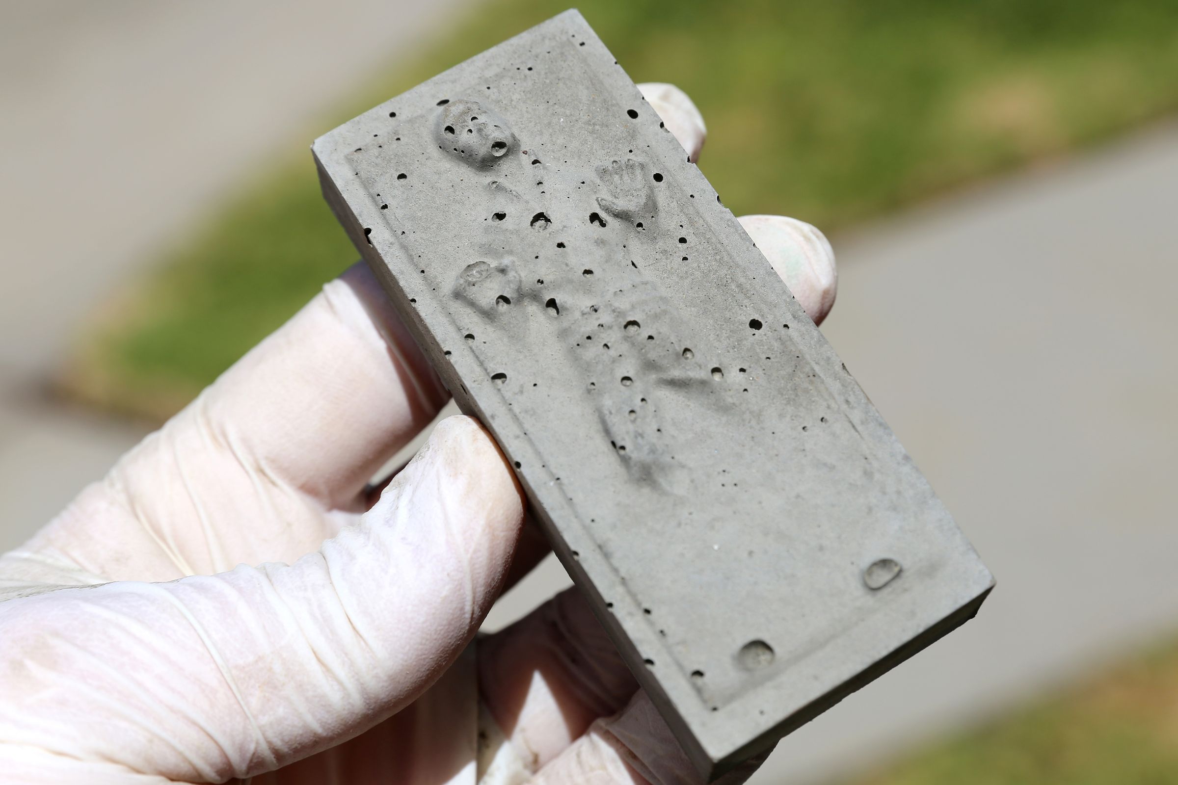

Concrete Has Bubbles After Removing From Mold
Bubbles are caused by not vibrating the concrete sufficiently after pouring. Take the time to really vibrate and shake up your pour in the mold and get all those bubbles. For deep molds try degassing after each short pour to release the bubbles as you go. Learn more about vibrating concrete in Lesson 2.

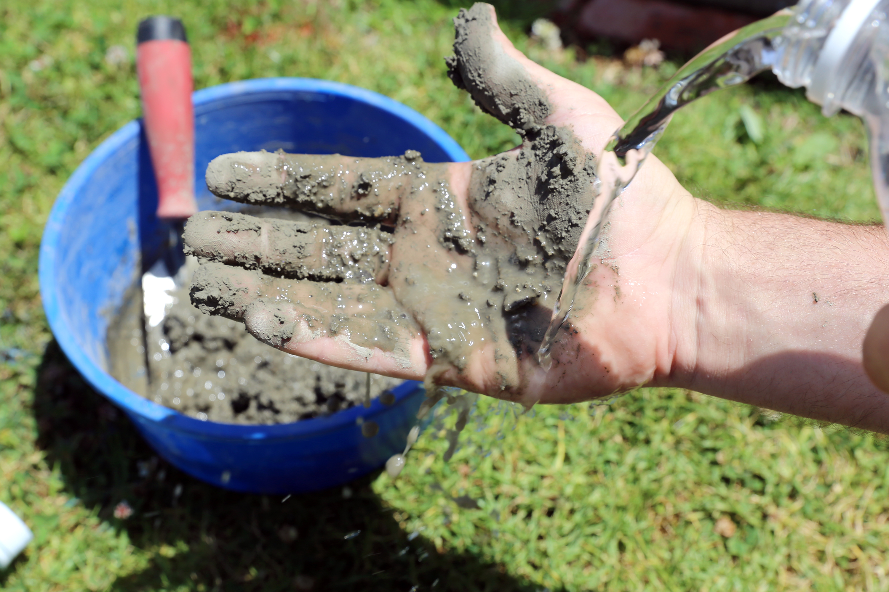

Ouch, Concrete Burned Me!
Concrete is alkaline, the opposite of acidic on the pH scale, which means it will cause burns when in contact with skin when it is wet. There are some steps you can take to minimize contact, like proper PPE, but there's also some triage treatment in case of emergencies. You can find all that info in introduction in Lesson 1.

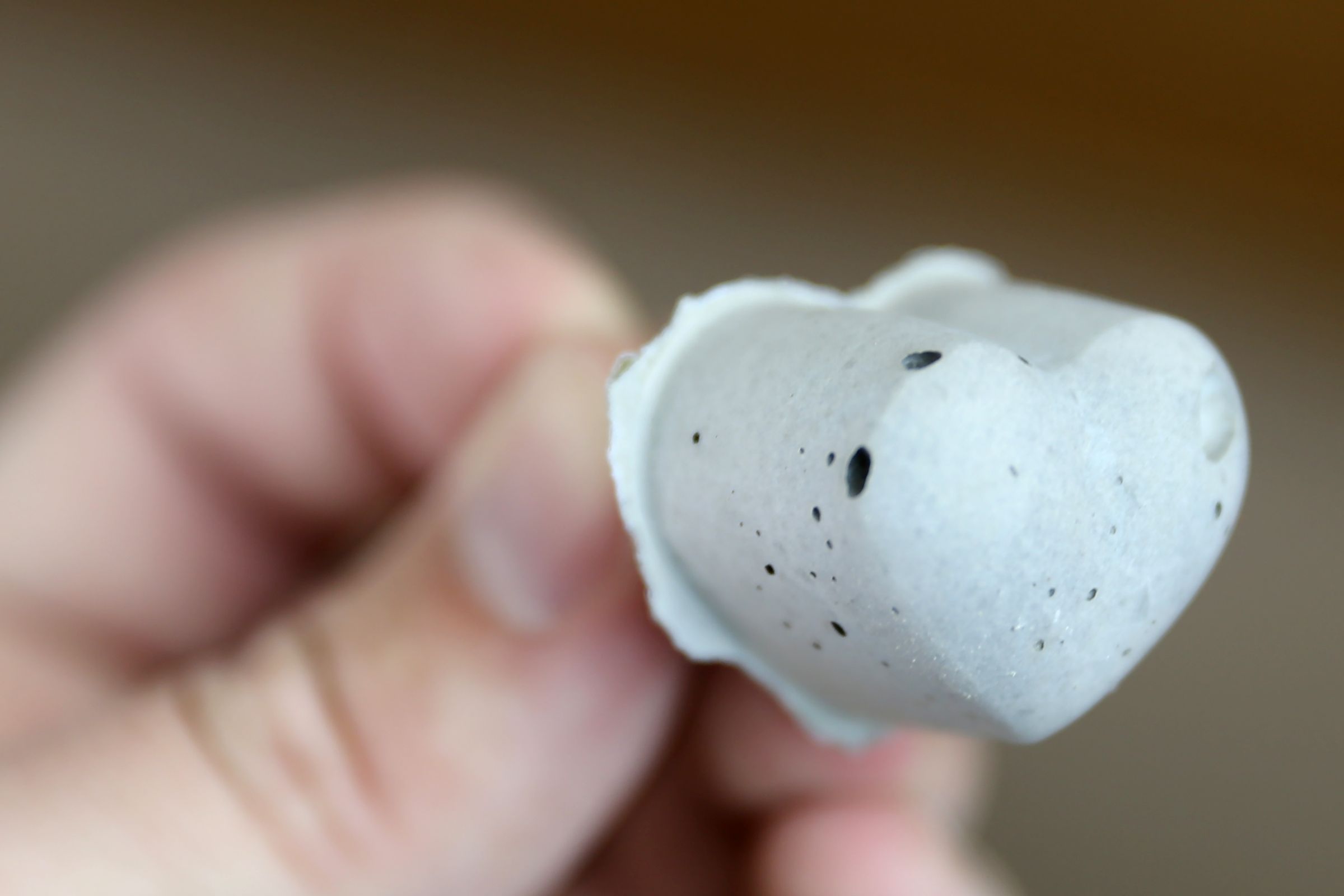

Lots Of Flashing on My Concrete
Flashing is caused by over-pouring in molds. While flashing isn't hard to deal with, it can add time to finishing your concrete piece, and larger flashing artifacts can sometimes break off and mar the finish of the cast piece.

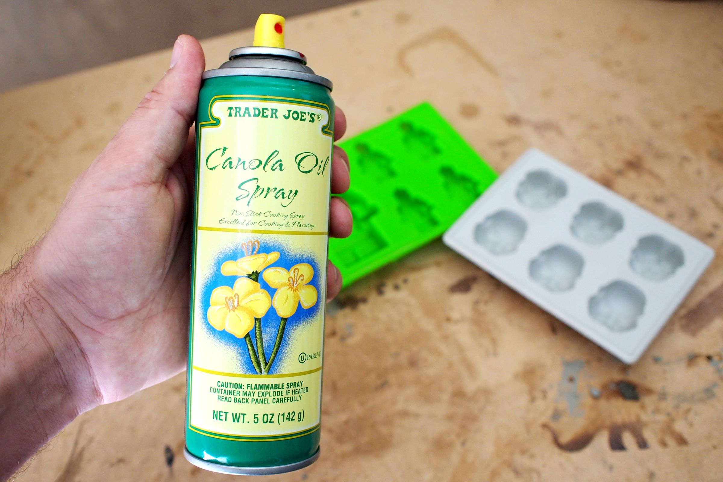

My Casting Is Stuck In The Mold
Did you you a release agent? There are specially formulated sprays that are applied to molds that allow castings to easily slip out after curing. However, regular cooking spray also works (and is probably more readily available).
