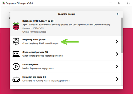

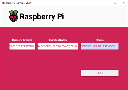

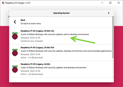

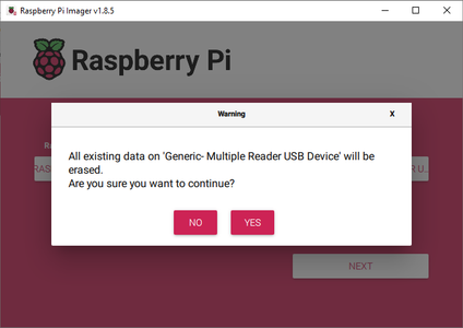

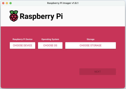

Visit https://www.raspberrypi.com/software/ and install the Raspberry Pi imaging program for your particular operating system. I'm using Windows, so that's the version I'm using. I'm also going to be using some other free Windows programs in the following steps, but there are free equivalents for other platforms.
Once you've downloaded the Pi OS imager, run the program. Select the Raspberry Pi device you are using. In this example. I am using a Pi Zero 2W. Next, select the Operating System to install. Since this device is going to run "headless" (without a monitor) there's no reason to choose one with a desktop environment. First, I clicked "Raspberry Pi (other)" and on the next screen I selected "Raspberry Pi OS (Legacy) Lite" because the description notes there is "no desktop environment".
Now, insert your SD card into your computer, and choose it under the "Storage" dropdown. But we're not ready to create our OS image yet! When you click Next, you will be asked if you want to "Use OS customisation?". Click "Edit Settings". This will let us set some important options for how the Pi is configured.

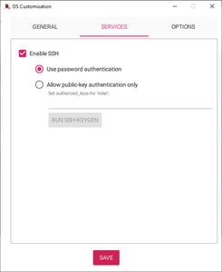

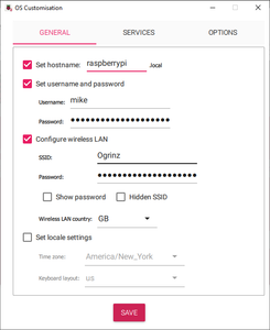

On the General tab of the next screen, you can set the default login account for your Pi. In this example I am using "mike" as my Username, and "password" as the password (Shhhh.. don't tell anyone). I've also set up the name and password for my local network so the Pi should automatically connect to it wirelessly.
Now click on the Services tab. It's very important that you check the box for "Enable SSH" and make sure "User password authentication" is selected. This will allow us to connect to the Pi remotely later on and upload files to it.
You can click Save on this screen and proceed with writing the OS to your SD card. This will take about 2 minutes and will completely destroy any existing files on that card - so make sure you don't have anything on it that you want to save!

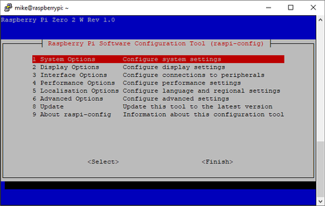

Step 2: Boot Up the Pi (Complete WiFi Setup)
There's always a wrinkle... Technically, you should be able to plug in the Pi without a monitor and keyboard and it should connect to your network automatically (that's why we entered the network name and password in the previous step). If that had happened, you'd need to find out what the IP address of your Pi is on your local network and could progress to Step 3. But, after some checks I realized that the Pi was not automatically connecting. Maybe the OS image we selected was to blame. But in any case, I had to hook my Pi up to a monitor and USB keyboard so that I could sign into it directly and complete the WiFi setup.

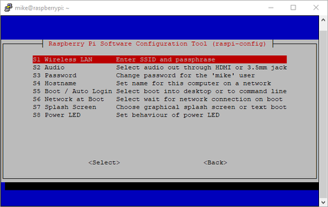

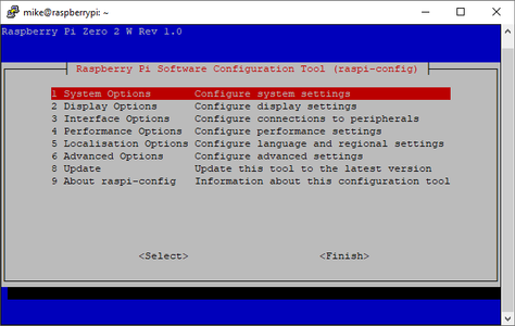

The Pi will prompt you for a Username and password. Use the information you provided in the previous step. Once you are signed in, type the command:
sudo raspi-config
When the Pi Configuration tool loads, select Option 1 for "Configure System Settings" (and press Enter). On the next screen, select the first option for "Wireless LAN" (and press Enter). You will then be prompted to enter your SSID and password (if any). As soon as you complete this step, your Pi should join your wireless network.

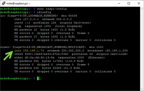

To confirm you have a network connection, exit the setup utility and type
ifconfig
If everything is correct, you should see a section in the output for "wlan0:" and in the line just below, the IP address of your Pi on the local network (it will probably start with 192.168.1. and a unique number at the end). Write this number down as we're going to need it again shortly.

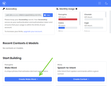

Open a browser and visit https://console.picovoice.ai/
Create a free account and login. This site will allow us to create a custom wake word file to use with pvporcupine. Under the free account plan, you are allowed to create up to 3 wake words (or wake phrases) per month.
Once you are signed in, you will see an Access Key on your homepage. Paste this someplace temporary because we're going to need it later. This key is just used to ensure you haven't exceeded the usage limits on the free account.

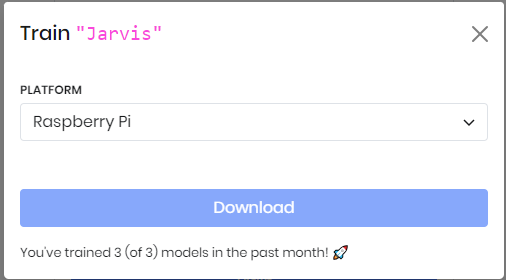

Now, click the Create Wake Word button on this page.

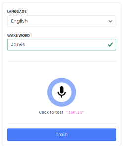

Enter the custom wake word or wake phrase you would like to use. In this example, I am using the ever-popular "Jarvis".
Tip: PicoVoice knows a lot of words, but it might not know something unusual or made-up. For example, for I wanted to use "Theopolis" as a wake word for a project, and that wasn't a word in it's dictionary. But I was able to spell it phonetically ("The-Opolis") - "Opolis" being the greek word for a city - and then PicoVoice accepted it.
If you have a USB mic (or webcam with a Mic) connected to your computer, you can test PicoVoice now by clicking the microphone in the middle of the screen. It's fun to keep saying your wake word and watch it get detected correctly. If you want to see how accurate Picovoice it, you can try saying words close to your wake word and see if you can get it to make a mistake. I've found it to be amazingly accurate.
When you're done playing around, click the Train button. Download the file for the platform "Raspberry Pi" to your computer. It will have a name that looks something like "Jarvis_en_raspberry-pi_v3_0_0.ppn".

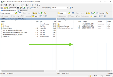

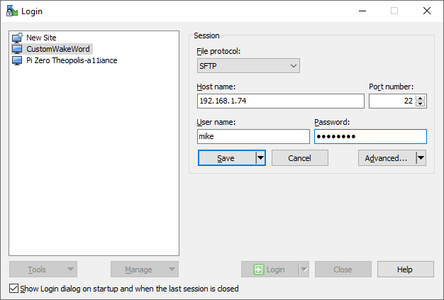

Now we've got to get CustomWake.py and your .ppn file copied onto your Pi. We're going to transfer them over using a program called "WinSCP". You can download it from https://winscp.net/eng/index.php
Create a new profile (I've called mine "CustomWakeWord") and set up the IP address for your Pi that you copied down in Step 2. You can also enter your Pi Username and Password. Then press the Login button. If all of your information is correct, you'll see a screen with the files from your local computer on the left, and the home directory for your Pi account on the right.
Navigate to where you have stored your downloaded .ppn and CustomWake.py files and drag them over to the right pane to copy them onto your Pi. When you're finished, you can close the WinSCP program.

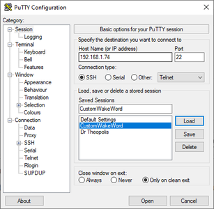

We're going to remotely connect to the Pi using a terminal program called Putty, which you can download for free at https://www.puttygen.com/.
Create a profile for your Pi using the IP address from Step 2, and then click the Open button. A connection window will open, and you can enter your Username and Password to sign in.

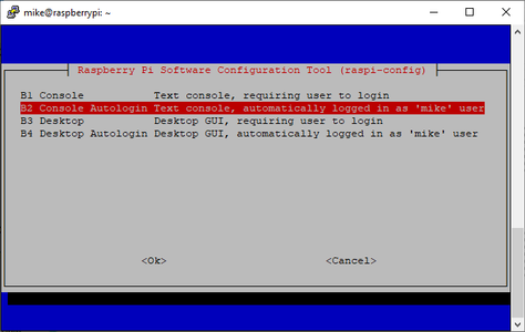

We also need to configure the Pi to auto-logon when powered up.
Type the command
sudo raspi-config
This once again takes us to the Pi's configuration menu. Select Option 1 (System Options), then Option 5 (Boot/Auto Login), and finally Option 2 ("Text console, automatically logged in as 'you' user)
Now your Pi will automatically sign in as you and start the CustomWake.py script whenever it's powered on.

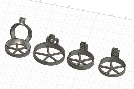

Step 9: Hold Me (AKA the 3D Print)
You'll need to print the 3D holder that will position the solenoid in the right spot for your particular Alexa model. This page on Amazon will help you identify what model Alexa you have and therefore which file to use.
My designs work, but they are pretty basic. If you're a creative person skilled with CAD, I've also included STEP files with this Instructable to use as starting point for designing your own solenoid holder.
If your solenoid is still connected to your circuit from the previous step, unplug it now. You'll need to feed the connector cable through the back of the holder. Push the solenoid tightly into the holder and give the plunger a couple of taps to make sure it moves freely. If it doesn't, you might need to carefully trim away a little plastic from your print.
Once the solenoid is installed, carefully slide/place your Alexa device in the holder. Make sure that the solenoid's plunger is positioned over the "action" button on your device (the small circle symbol). Reconnect the solenoid to your circuit. You can also plug in your Alexa device at this time.
