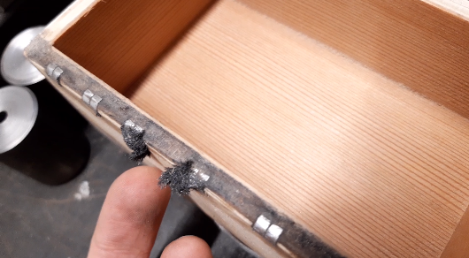

Step 2: Insert Magnets
Now comes the work with the magnets as the real novelty
I think, the magnetic hinge. First I made cutouts with the knife in the two rear walls, in which the magnets will later be embedded. When arranging the magnets, the following should be considered: I used 10 magnets per wall and glued them in pairs in a cutout. The polarity of the magnet pairs must be selected so that they attract each other. The following pair should be glued upside down as illustrated in the picture. This arrangement is intended to cause the magnetic field lines to spread apart from the axis of rotation of the hinge.

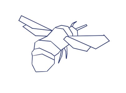

Step 6: Bumblebee As an Inlay

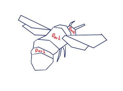

First I thought about the design of the bumblebee. This point does not apply to you if you feel like working according to the picture below. When choosing a veneer, I thought about the following: the body of the bumblebee should be made of the same wood, namely oak. The dark pieces were ebonized with an iron vinegar solution and the light oak pieces were left natural. It is important to use the same wood so that the structure of the bumblebee fits each other over the entire body and looks harmonious.

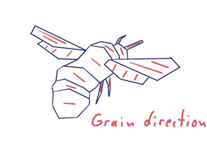

The wings were made of a different wood, here you have to pay attention to the grain (see the picture). First you put the parts of the bumblebee body with the wings together and fix them with adhesive tape. Then the body is placed on top and fastened. Then cut out the outline as precisely as possible with a knife. Now you fix the bumblebee body in the resulting cavity, once again you can make do with tape.
Now all that's missing is the little bumblebee's legs and antennae. Their outlines are cut out of the base veneer on the top with a knife. The resulting windows / small cavities are then used to cut out darker wood in the exact shape and then to embed it. So you put the basic veneer with the bumblebee on a darker piece of wood and transfer the shape of the window to the lower veneer, which is then cut out and inserted. Now for the last step, the entire upper veneer, which is connected by adhesive tape, is then glued on.
