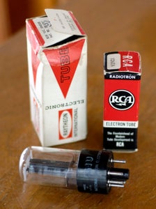

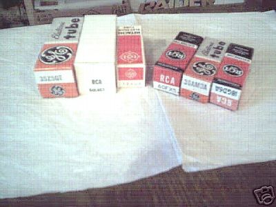

--New tubes
Tubes availability can be an issue. But many manufacturers continued making tubes long after they were considered obsolete. And Russian-made tubes are still produced today.
Generally, N.O.S. tubes from US or European sources are preferred (N.O.S. or "new-old stock" means: manufactured previously, but never placed in service.)

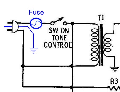

Look for at least two transformers--every tube amplifier has an output transformer hooked to the speaker. But some old amps forgo input (power) transformers, and are wired directly (indirectly, actually, through a single cap) to the AC line voltage. This type of wiring lacks 'isolation' and is dangerous! If that one old cap fails, you're a conductor! (in the electrical, not the musical sense.) Check online schematics if you can't inspect the amp personally.
The Kay 503A is a bit of a hybrid. It has an isolation transformer--but only for the amplifier circuit, not the tube "heaters." This is not ideal, but it is safer than no isolation at all. With a bit of rewiring, it's not too bad. A separate power supply for the heaters would be the best option, however. Or an external line isolation transformer (replacing the AC heater circuit with an isolated DC supply will also reduce hum.)

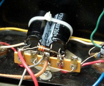

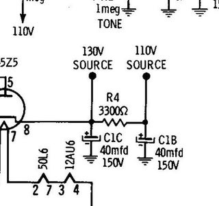

So it's quite easy and common to replace with individual polarized capacitors. I removed all the wiring from the can, then rerouted to the new caps with a terminal strip. Terminal strip are cheap, simple to use, and very common in vintage gear.
The terminal strip was attached to the chassis with a steel pop rivet and steel rivet backing-plate. The hole was pre-existing (cool!) but drilling a new one would be easy.
The old 'can' was left in place for looks, and for a reference to whoever 'recaps' this amp in the future.
The filter caps, originally rated at 150V, were replaced with 350V versions. Yes, you caught me--the 20 uF bypass cap is still only 160V, because that was the only one I had on hand (This is part of Mod A--I've since replaced it with a 10uF 350V cap...)
When replacing the filter caps, don't exceed the capacitance values by much (I went from 40 uF spec to 47 uF.) More capacitance sounds good, right? Less hum, you say? Unfortunately, amps with tube rectifiers can't handle high capacitance values--they cause voltage spikes that wear out the rectifiers quickly. 60 - 100 uF is the recommended max for this type of rectifier...stay near the spec values here.

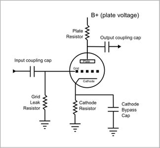

Other than the filter capacitors, the other caps in the amp will be one of these (Step 8 will help you identify each of these types) :
1) Coupling Caps -- connect the signal path between stages
2) Tone Caps -- roll off different frequencies to ground, for tonal effects
3) Cathode-Bypass Caps -- integral part of "cathode biased" circuits
Most of these caps will be of the non-polarized variety. The occasional cathode bypass cap could be a polarized, however.
The coupling and tone caps should have voltage ratings comfortably higher than the max voltage the circuit might see--with cap and induction spikes, just assume these should be 400 volts or greater.
The bias voltage for tubes rarely exceeds 10-15 volts, however. A 50V capacitor will work fine for the cathode-bypass caps.

Make one change at a time. Really large changes will probably be...unsuccessful (unless you really know what you're doing, or the design was flawed to begin with.) Here are some examples:
--Change coupling caps. They'll effect the tone. Smaller values will be brighter, larger values will add bass.
--Adjust the " grid leak resistor ," which effects the impedance and the gain of the stage.
--The initial input attenuation/RC network can be adjusted (resistors directly after the jack.)
--Cathode bypass caps on both the preamp and the power amp stage can be adjusted. This effects both the response and the tone (to a lesser extent.)
--Changing the values of the Plate Resistor and the Cathode Resistor have a direct effect on the gain, headroom and distortion. Don't do this without a thorough understanding of the tube's characteristics, however.

--Grounded plug mod (see the page Three-prong plug safety mod.)

A second, larger cap (0.068uF) was added with a cut-out switch, so a fuller, jazzier tone can be added at will. The difference is subtle, but noticeable. I find it's difficult to be objective about the tonal effects of cathode bypass caps, but changes seem to alter the response, or 'tightness' of the attack, and to a lesser extent the overall tone...as though the note 'envelope' itself were subtly changed.
--The preamp-to-power-stage coupling cap was changed from .005 to .001uF. Again, more high-end boost.
--The volume control POT upped to 1 Meg (from 500K.) Since it also functions as a grid leak resistor for the power amp, this extra resistance ups the gain. Well, less signal attenuation, anyway. The additional distortion is noticeable...
Replacing with a 2 Meg POT, or moving the volume control to the preamp are other options for punching up the power stage.
--The power amp cathode bypass cap is now 10uF, further enhancing the high-end response (or actually, reducing the bass.)

Step 13: Three-prong Plug Safety Mod
If your amp doesn't have a grounded plug, then this mod will make it both safer and quieter. I reused a computer cord. This hasn't completely isolated the amp from line (the heater circuit mentioned in previous references), but it should be safe enough to use.
A grounded AC plug (in the USA) has the following color codes:
--BLACK : Hot
--WHITE : Neutral
--GREEN : Ground
Route the black wire through a fuse holder to the power switch. The white wire is connected directly to the transformer. Connect the green GRD to the chassis ground. This means screwed or riveted directly to the chassis--not just soldered to an existing grounded wire.
The fuse holder (and fuse) was added, not being OEM for this amp. So a 1/2 hole was drilled for mounting.
A larger rubber grommet replaced the original cord grommet. The 'stress relief' consists of two zip ties, and could be better...
Here's an in-depth explaination of the mod: http://www.rru.com/~meo/Guitar/Amps/Kalamazoo/Mods/safe.html
For folks outside the US, the international power cord color codes:
--BROWN : Hot
--BLUE : Neutral
--GREEN/YELLOW STRIPE : Ground
