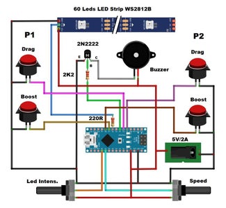

  1. Arduino Nano R3
  2. WS2812 Addressable LED Strip.
  3. Transistor NPN
  4. Rotary potentiometer x 2
  5. Pushbutton x 4
  6. Resistors x 2
  7. Buzzer

Step 4: Conclusion, Schematic, and Code
And finally a short conclusion. This is an interesting simple to make Arduino game that can be made in less than a day. The simplicity is due to the LED strip consisting of 60 special LEDs with built-in chips, so at any moment we have full control of each LED individually thanks to the Adafruit_NeoPixel library. The device is built into a suitable box made of PVC material, and covered with colored self-adhesive wallpaper. The power supply is 5V and a minimum current of 1A.
