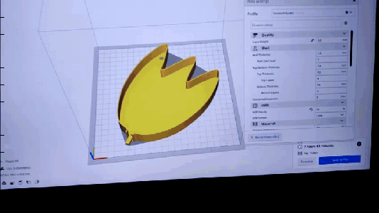

Step 3: 3D Printed Parts
For 3D Printing the Parts, I used Black and RED PLA for the Base and Transparent PLA for the diffuser part. However, the stalk lid is printed with Black PLA as the stalk won't contain any LEDs.
As for my Printer settings, I used a 0.5mm Nozzle with 0.2mm Layer height at 20% infill. I'm using Cura slicer here.

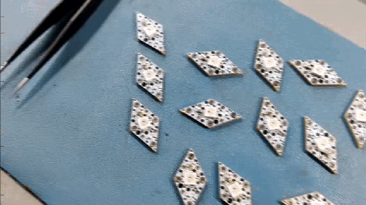

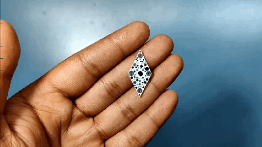

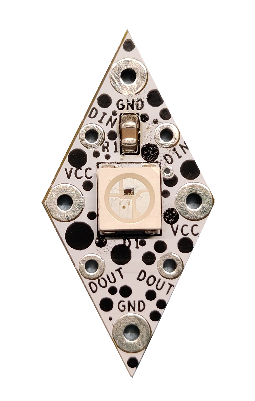

Step 5: PIXIE Board
This is the PIXIE Board, it's a WS2812B Breakout Board that is shaped like a polygon.
My idea is to lay out this PIXIE board inside the Petal and Leaf base, then with the help of silver copper wire, I connected each board's VCC and GND together along with Din and Dout Sequence.
This was the plan, A simple plan.
Step 6: Schematic of PIXIE
I first prepared a schematic for this PIXIE Board and then converted it into a Board file, then I prepared the basic shape of a polygon which was 14mm x 7mm long.
At the center of Polygon, I placed WS2812B LED along with the 100nF Cap and then arrange the VCC, GND, Din, and Dout Pads in the right way. After finalizing the PCB, I exported its Gerber data and send it to PCBWAY for samples.

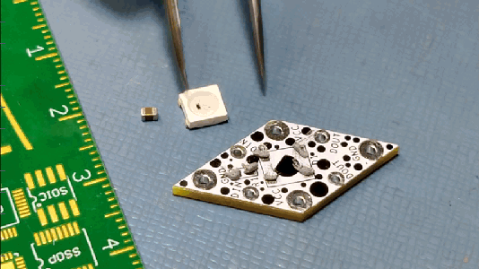

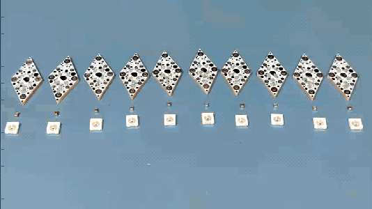

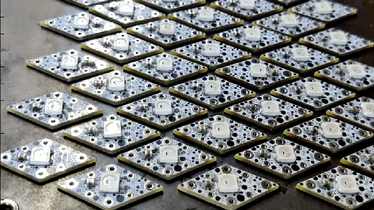

Step 8: ASSEMBLY PROCESS for PCB
The Assembly process of the PIXIE Board includes mainly three steps
- solder paste dispensing process
- pick & place process
- hotplate reflow
Step 9: SOLDER PASTE
First, we place solder paste on each components pad, I'm using a generic solder paste (SN-Pb Ratio 63-37) with a solder paste dispensing syringe.
Step 10: Pick & Place Process
Then we add components to their assigned place one by one. You could see the schematic for the precise location of each component.

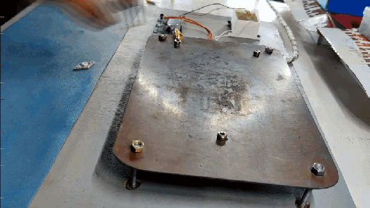

Step 11: HOTPLATE Reflow
After adding components to their location, we carefully lift the PCB and put it on an SMT hotplate.
I made this Hotplate especially for making projects like these which require SMD soldering.
hotplate available in the market were not exactly cheap so I made a minimal version of that which you can check out from here- https://www.instructables.com/DIY-SMT-Hotplate-Pro...
But anyway, the hotplate heats the PCB from below up to the solder paste melting temp, as soon as the PCB reaches that temp, solder paste melts and all the components get soldered to their pads.
We carefully lift this PCB and try not to shake it as the solder paste is still melted and components might stray from their location if moved too much.
we lift the PCB and then place it on a cooler surface for a little bit, to cool down the heat of PCB.

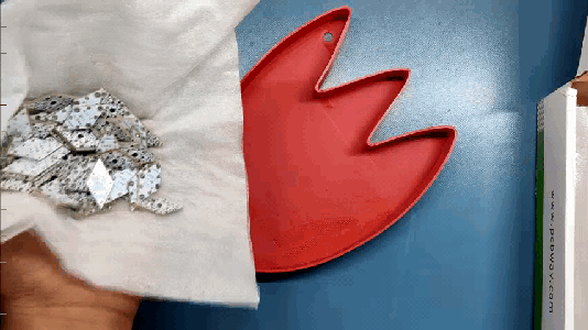

Step 12: REDO the Whole Process for 49 Boards
To make all 49 boards, we have to redo these three steps for all PIXEL Boards.
so I prepared the remaining PCBs which took a lot of time and effort.

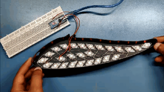

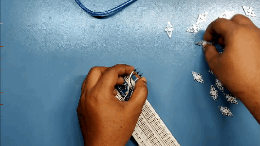

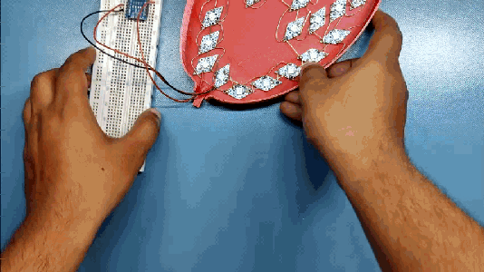

Step 13: Testing Setup
Next, I prepared a simple Arduino + Jumper set up to test each board.
Wiring for the testing Setup
- VCC of PIXEL Board goes to 5V
- GND to GND
- and Din of PIXEL Board to D3 of Arduino Nano
Step 14: CODE for Testing Setup
I added the above sketch to the board and manually tested each Board one by one and after making sure that each PIXEL is working, I started the assembly process.

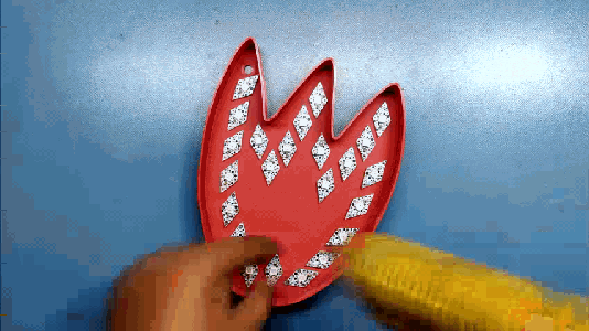

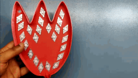

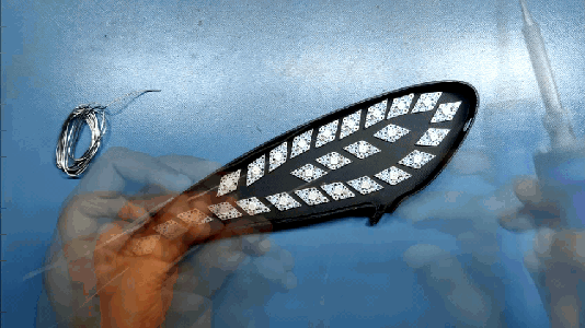

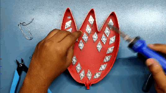

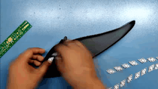

Step 15: MAIN BODY ASSEMBLY PROCESS

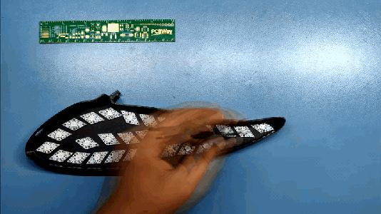

First, I prepared the Leaf portion of the project.
- I first arrange the PIXEL Boards in a proper alignment. by proper I mean in a better orientation so the soldering job would get easier.
- then I used hot glue and glue each PIXEL Board to its assigned location one by one. I used a total of 26 Boards for the leaf part and after gluing them to the leaf all that left to do is the wiring.

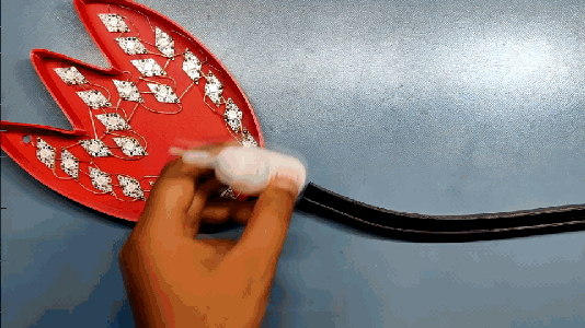

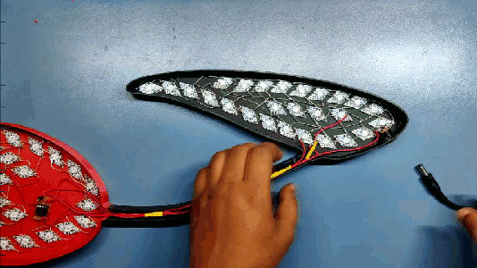

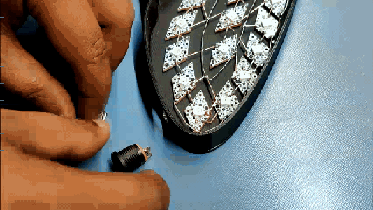

Step 16: Schematic of PIXIE Connections
- Wiring of the Leaf part includes connecting all 26 Boards in parallel together and also arranging the Din and Dout of LED Boards.
- I first connected the Dout of the first PIXEL to Din of Second board, then Dout of second board to Din of Third board, and then the Dout of the third to Din of Fourth, and the list goes on and on.
- then after this, I connected all the VCC and GND also.
- I used mainly Silver copper wire and remaining cutouts from LEDs and resistors which I collected for moments like this.
- Connecting wire to VCC and GND of each Pixel is a hellish work.

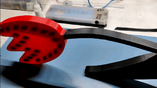

Step 18: 3D Printed Parts ASSEMBLY
Next, I gather all the bottom parts which were Petal, Stalk, Leaf, and then put them together with help of super glue.
I used Superglue to joint Petal with stalk first and then another end of the stalk to Leaf.
A total of two joints was superglued together.
After Superglueing all three parts together, we get a huge single Tulip that contains RGB LEDs inside.

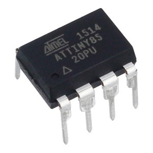

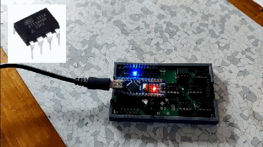

Step 19: Selecting the Right Microcontroller for Driving LEDs
The brain of this project is the mighty Attiny85 MCU.
The reason for using Attiny85 over the previously used Arduino nano is pretty simple actually. Cost and over-killness.
Attiny Cost very very very less in comparison with the Arduino Nano Board. Also, in this project, the space of placing the circuit is an issue and an Arduino board will need more space. also, only two Digital pins are being used so why to choose a Microcontroller with 13 pins that would just sit idle.
To keep things simple and easy to use, I choose Attiny85 which is a low-power Microchip 8-bit AVR® RISC-based microcontroller that combines 8 KB ISP Flash memory, 512B EEPROM, 512B SRAM.
It has six IO Ports and operates between 2.7-5.5 volts which is ideal for our application which is to drive two separate WS2812B LED lines from D0 and D1 Pins.
I prepared a simple Perf board Setup according to the below schematic. For Plugging and unplugging the Attiny85 on the circuit, I added a DIP8 Socket for convenience.
The idea here is to flash the Attiny85 before putting it on the IC socket, if in the future I want to alter the code, I can remove the IC from its place and Flash it, then put it back on.

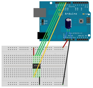

Step 21: Flashing Process With Arduino As ISP Programmer
As for the Flashing Process, we cannot directly program ATTINY85 through any USB, I mean there's a method for programming the Attiny straight from the USB port but I'm not doing that.
Instead, I'll be using the ISP flashing method which will utilize the SPI Pins of attiny85 to burn the bootloader in it and then Flash.
Getting Attiny13 Core Installed on Arduino IDE
Before starting the Flashing process, we first need to download and install the Attiny85 Core files in Arduino IDE.
https://github.com/SpenceKonde/ATTinyCore
- File->Preferences on a PC, or Arduino->Preferences on a Mac, enter the above URL in "Additional Boards Manager URLs
- Tools -> Boards -> Boards Manager... *If using 1.6.6, close boards manager and re-open it (see below)
- Select "ATTinyCore by Spence Konde" and click "Install".
AVRs chips usually come blank, they need to be set up to be Arduino IDE compatible but to do that you need an AVR programmer do to that, for example, a USBASP.
Fun Fact, you could make your own AVR Programer with an Arduino Uno or a Nano board in a very easy step.
- Connect your Arduino board with com port and select the following sketch
- Example>ArduinoISP upload this sketch onto your board
- After uploading, go to the tools menu and choose the Arduino as ISP option in the programmer section.
- Now for flashing Attiny85, we can select the Attiny85 in the Board section.
The programming process uses VCC, GND, and four data pins. Three pins connect MISO, MOSI, and SCK between the programming micro and the target micro, the fourth pin from the programming micro goes to the reset pin of the target.
Wire the Attiny85 with Arduino in the above way. (also right after uploading ISP Sketch to your Arduino, do not forget to add a 10uf Cap between Reset and GND pins of your Arduino board)
Instead of using an Arduino UNO and a breadboard for this job, I will use my DIY Attiny Programmer which I made for flashing the Attiny or Atmega MCUs.
https://www.instructables.com/Multiple-ATtiny8513A...
- connect the Board to the Arduino as ISP Setup in the above wiring config
- choose the right port, right programmer (Arduino as ISP), and hit Burn Bootloader
- wait for few seconds, you will get done burning the bootloader message.
- Now Open the sketch that you want to upload to this AttinyGo to the Sketch menu and select Upload using the programmer.
- and your Sketch will get uploaded onto the attiny85.
Also, because the programmer I'm using has DIP sockets, I just plug the MCU in it and flash the code inside it, then removed the MCU.
Now after Flashing the MCU with the main code, I added the Attiny85 on the main circuit and started the final wiring process of this project.
Step 22: FINAL WIRING
above is the main wiring diagram of the overall setup
The goal here is to connect Attiny85's VCC to VCC of LEDs, GND to GND, D0 to Petal's RGB Din, and D0 to Leaf's RGB Din with wires.
Also, for powering this setup, I'm using a generic Barrel Jack connector.
I added an IN5399 Diode in between the VCC of Barrel jack and Attiny85 and connected its GND to the GND of Attiny85.

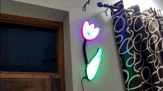

After this, the wiring is done, Now we put on the Lid on all three bodies and hang this setup on a wall.

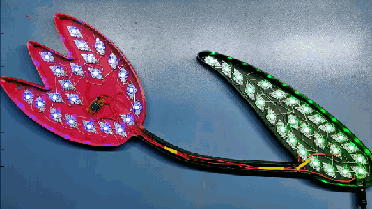

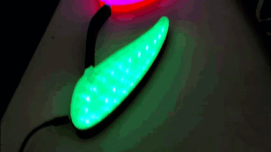

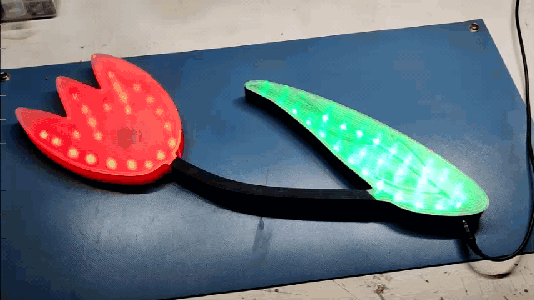

Step 24: RESULT
Here is the result.
This setup works something like this, so the green LED will stay on forever and the tulip LEDs will randomly shuffle between RED and BLUE shades.
This can be altered by tweaking the provided code or add a whole new code into this setup.
