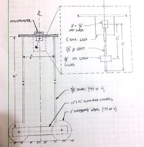

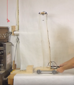

A rough sketch of the model is shown above. You really just need something that wobbles, so use whatever scrap wood you have on hand. A couple of important points:
  • I recommend adding braces between the front and back dowels. This will help constrain the wobbling to just the X-axis where you will be measuring. Otherwise you might get some swaying front to back which will muddy your results.
  • I added a bungee cord and stopper to give a consistent "bump" to the structure. You may be able to save yourself the trouble of this whole part by just mounting the structure to a sturdy base and "plucking" it like a guitar string to get it started swaying. It would be much simpler, but I'm not sure if you could do it consistently.

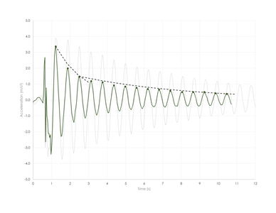

  • Lock the pendulum from swinging and set the building swaying. The accelerometer data will show the peak amplitude and the slow decay of the motion.
  • Calculate the building's natural period by measuring the time between two peaks on the graph.

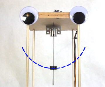

  • Calculate how long your pendulum needs to be to match the building's natural period.

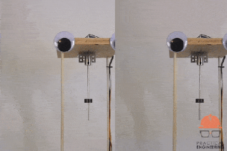

  • Loosen the screw on the pendulum so that it can swing but not freely. You want the pendulum to stop swinging after only one or two periods if you start it with your hand. This confirms that the pendulum is "damping."
  • Set the building swaying again. Some of the kinetic energy should be transferred into the pendulum which dampens the motion. The motion should decay much quicker.

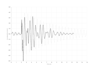

  • If the pendulum is not damping enough, it will transfer the kinetic energy back into the building (see the last figure above). You don't want this, since it would make for a wild ride for our topmost tenants.
  • You can use the logarithmic decrement equations to calculate the damping ratio for the two examples. I recommend using the amplitude from the first and second peaks, since this is where you will see the most damping from the pendulum.
