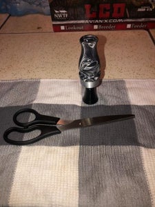

Tuning a duck call can be hard, but if done correctly it will make calling a lot easier out in the field, slough, timber, or swamp. Tuning a duck call is all preference just like in life everyone has a preference on how they do things the way they like to do it. I've spent 5 years out in the field and water trying different tuning techniques. The things to have for this demonstration are a single reed duck call, which can be an expensive or cheaper one, and a pair of sharp scissors, preferably fine cut scissors.

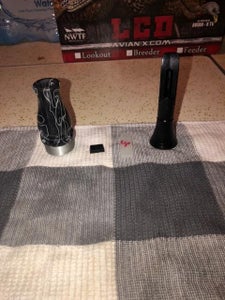

First, the disassembly process; take the barrel of the call (The end that gets blown into) and pull it apart from the insert (This piece goes inside the barrel). Take the wedge out (cork or rubber) the wedge will be in the slit of the insert, I will be using a rubber wedge. The wedge may be snug in there; either use scissors or something with a dull end and push it out. Next take out the reed. The reed is thin, normally white, and squared plastic. The reed is made of mylar, so be careful not to rip it in this process.

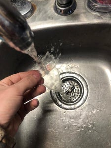

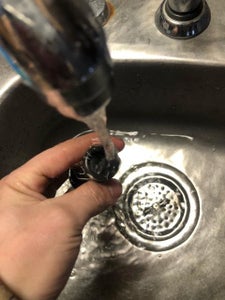

Next, take the insert and reed and run it under water and clean them and then dry them off. Secondly, check for cracks or scuffs in the barrel, reed, wedge, or insert. If something is wrong with it, buy a new piece.

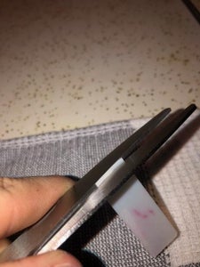

Third, grab the reed and identify the back of the reed, normally squared off to match the back of the insert. Cut with your fine scissors only four to five thousandths of an inch off the squared end of the reed at a time. However, if too much is taken off it can make the call not sound correct and will have to order a new reed.

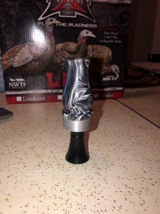

Fourthly, reassemble the call; be sure when putting the reed back in put the reed between your thumb and pointer finger and squeeze gently till the reed bows. The direction the reed bows should go downwards on the insert. Then slide the squared end all the way to the back of the insert, try to square the reed on the insert width wise. If not placed right will end up with no sound. Then place the wedge in, sometimes you will have to wet the wedge a little to slide easier. I normally use the non-sharp end of the scissors and push it down to get more leverage. Make sure the wedge is in correctly so the barrel of the call can slide over the insert.

Finally, blow and see if it sounds good. If higher pitched is wanted; cut off a little more until it sounds right for your preference. The more that is cut off the easier it is to blow. Blow the call with a single “quack.” Once the quack sounds good add in high end note known as the “hail.” If desired, then add a series of high- and low-end notes and trim till it is to your liking.
