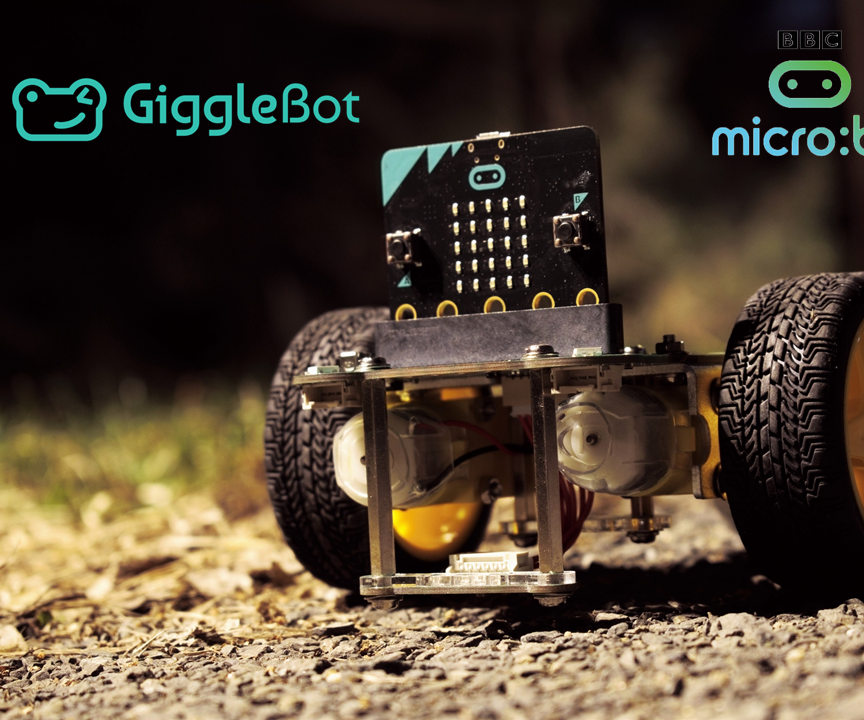

Introduction: Tuning the GiggleBot Line Follower - Advanced
In this very short Instructables you are going to tune your own GiggleBot to follow a black line. In this other tutorial GiggleBot Line Follower, we hard-coded the tuning values to work according to that scenario. You might want to make it behave better by coming up with other gains.
In this tutorial, we are showing you 2 scripts that can both be loaded on different BBC micro:bits so that one of them is put into the GiggleBot and with the other one, the 2 buttons are used to go through a menu and tune different parameters. The sending of these updated parameters is done via the radio.
