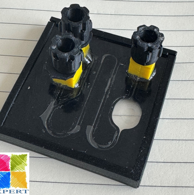

In principle, the turbidimetry probe consists of a light source and a photoresistor, which are at least one centimetre away from the solution to be analysed. The light source can be either a fixed-length LED or an RJB LED, which allows us to choose the wavelength.
The probe is a 3D-printed body made from polylactic acid (PLA) that enables the components (diode, photoresistor and wires) to be integrated into a cylindrical structure. The cylindrical body is made from a recycled felt-tip pen barrel. Only the head, which incorporates the diode, photoresistor and wires, is 3D-printed.

Step 1: The 3D-printed Probe Heads.
The two probe heads are printed in two symmetrical parts so that it can be easily assembled.
The design of this probe head must be adapted according to the type of LED used. In our case, we have designed two types of head :
  1. The first one on the left is designed to hold a standard monochrome or white LED with a diameter of 5 mm. The cavity for housing the pen tube measures 8 mm. The entire device comes in the form of a 10 mm 'tube' that can easily be installed in any reactor or sample holder. The bottom of the probe houses the LDR. A window allows the liquid to be easily passed through for study. The LED is located opposite the LDR.
  2. The second one from the right is for the larger RGB LED. Although it has the same components as the monochrome LED, such as the pen tube housing and window, the body of the head is wider to accommodate the LED. This allows us to create a wire path for the LDR.
