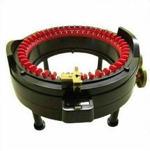

I have recently been given an Addi Express King Knitting Machine, the machine was not in fully working order, initial thoughts were that the cranking handle spigot had snapped as the handle would just spin and not rotate the drum, with nothing to lose I decided that I would try and repair the Machine.
It was at this point that I thought to myself instead of modifying the machine to as was, why not turn it into a turbo knitting machine, who wants to crank a handle hundreds of times when a motor can do the work, fair enough you still have to watch for any dropped stitches etc, but at least your hands are free to do other things.
The way these knitting machines work is you manually cast on one row, then the machine takes over whilst you crank the turning handle for however many rows you need, this could be 400+ if you are knitting something like a scarf, a double thickness beanie hat would be say 120 rows.

The first motor I tried was only 200 rpm and far too slow for this project, I tried disassembling it to try and alter the gearing but that failed miserably so in the end I opted for one of the N20 500 rpm geared motors(See Image) which after putting it through a trial with some wool was clearly not up to the job, I had designed and 3D Printed a housing for that motor as well.
I sourced a 12v 400rpm high torque motor, again this was not expensive, this should be adequate, slightly larger at 25mm diameter I would need to cut away some of the plastic motor housing, hey what's to lose, the machine was a freebie!
I managed to salvage the original gear which turned the cylinder via the crank handle, this was cut-off with a Dremel cutting blade, I had to design an adapter for this, which meant drilling the center out to fit the adapter so it could be fitted to the shaft of the DC Motor, this could be glued in using CA Glue once everything is aligned correctly, Unfortunately this failed, the shaft has a flat spot on the motor and I couldn't replicate this, so I decided to design a new gear, with the correct hole including the flat spot, I also designed in a 3mm threaded hole between the gearing where I could insert a 3mm grub screw to tighten against the flat spot.
As the geared cylinder sits directly on the base of the drum its important that the gear on the motor is aligned correctly for a smooth operation.
I ended up using 5 minute resin to secure the motor, this was the best solution, it took a few attempts to get this aligned correctly, but once in place it worked well, 12v was ample to spin this motor and rotate the plastic ring, I had completely removed the row counter prior to carrying out the initial motor test as this was a major sticking point.
