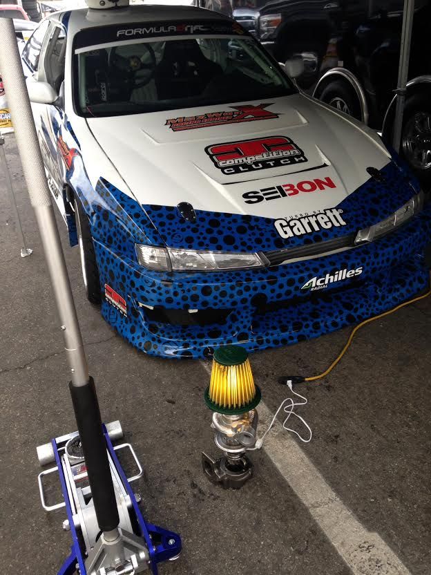

Recently I had some automotive parts laying around the shop and decided to make a lamp out of a spare turbocharger and a automotive air filter. I have had alot of positive feedback from car lovers and mechanics so I figured it would be perfect to start making them for friends for there "man caves" and shops.

You are going to get your 6 ft candelabra base and take it apart because the socket will not fit up the steel tube, even if it could the switch part would hit the base before it made it up to the washer. Take it apart and make it so the switch is a foot and a half away from the socket when you rebuild it so it can reach the washer where it will sit with the light bulb in it.
I did my best to try have photos for this process if you have any questions feel free to message me.
Step 8: Finished!
Put a light bulb in the socket and put the filter over it and its done!
