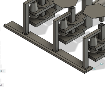

Step 2: Silo Printing
These are for the Silos. I have intentionally left out the three big pipes because I found out they obstructed the assembly in real life, so just print the files here.
Note: these dhould be printed in multiples.
tbearing x6
tbottom x3
ttop x3
tcomponent21 x3

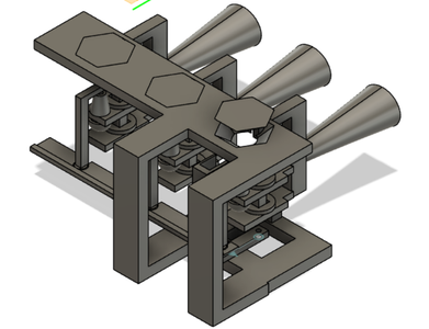

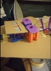

Step 3: Assembly
After you remove the support material from the prints, it's time to assemble.
Start by gluing the two parts of the base together as in the image.
Step 4:

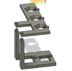

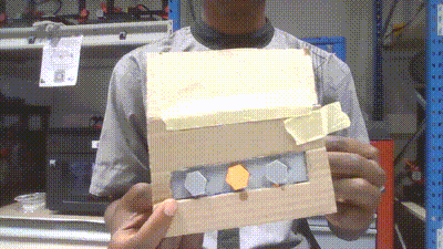

Continue by gluing these parts like so, 3 T-component 21s, with the base. that is, the parts with two holes each in them, you glue the notches on the base into the holes of the T 21s. In the second photo I highlighted them for clarity.
then add in the tbearings and glue them as shown in picture 4 and 5.

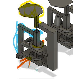

Step 5:

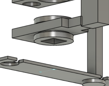

Then you insert each T-bottom(highlighted in blue) into the T-21s. I highlighted each of the three pairs in red in the second picture, again, for clarity.

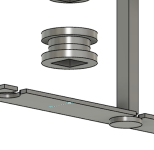

Step 6:
You then insert t-top(yellow) through the top of the base and it fits into t-bottom as shown in the first image. t-top will go through the base and into t-bottom

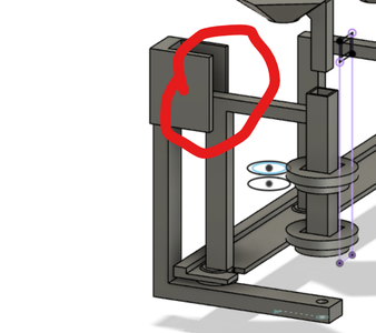

Step 7:
Clip on the "parallel" into the threeT-bottoms. It's the gray peice in the second image
Step 8:

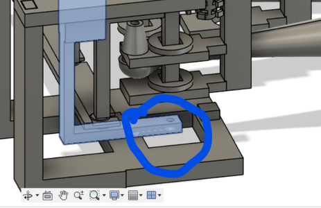

Add in the t-arm and a motor to move it in the hole as shown.
The motor goes into the rectangular hole in the base and the shaft goes into the hole on the arn highlighted in blue.
assemble the arm and the motor first, then put them into the base assembly through the rectangular hole.
The arm should hold t-bottom as shown in the third image.
Step 9:
The silo tops should now be able to move together if you assembled the parts well.

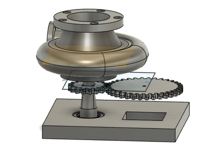

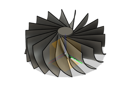

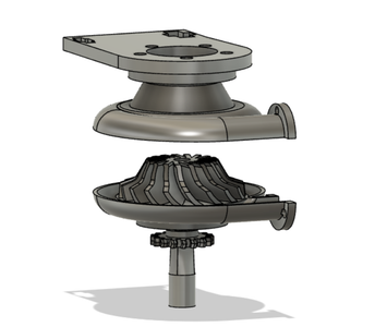

Step 10: Turbocharger Assembly
Push in the imeller shaft into the impeller as shown in the second picture, and then glue on the square shafted gear. After that, glue on the square end of the gray shaft to the gear.
Step 11:
Put the assembly into the bottom half of the turbo-casing, and add the top half and glue them together.
Step 12:
finally glue that to the base
Note: forget about the floating gear you see now. When you add in the motor, then, you will connect it to the
gear.
you might also want to expand the shaft hole a little, depending on the size of your motor's
shaft.
Repeat the process for the second Turbocharger and...

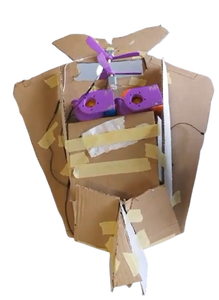

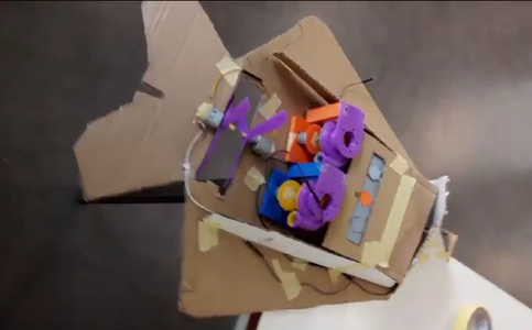

Step 13: The Frame
You can just cut out any frame that looks good to you for your aircraft, I didnt really use a template, just got a bearing from watching some videos on how to make plane frames from cardboard.
For this step Just go watch some videos, I wouldnt wan't to limit you to the specifics of this craft, and it's not perfect anyways, so spur your imagination into action!!!
Then place your turbo chargers on each side, and the silo assembly in front of them.

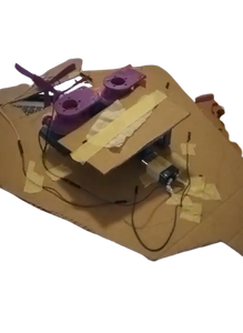

Step 14: Propellers
Wrap some tape on the shaft of your motors to make them thicker and then insert the propellers on to the motors.
Make sure the curved edge is the leading edge at all times and you'll have make sure you orient them correctly because one motor will face the front while the other will face the back.
In short:
Just make sure when they spin, they push air to the rear and the curved edge is the leading edge.
Cut a hole in the rear of your frame for the propellers to fit into.
Then glue them on to the frame like I did, but make sure they are aligned properly.
