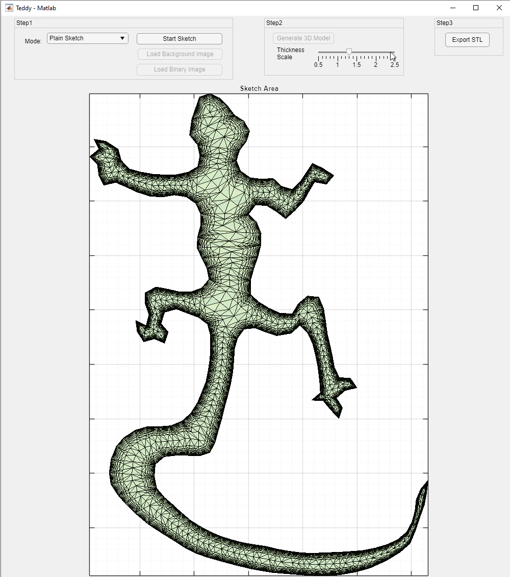

If you see the app interface like below, you've successfully started the app!

This software has 3 steps:
1. Sketch
2. Generate 3D model
3. Export *.stl (for 3D print)
and let me describe each in turn.

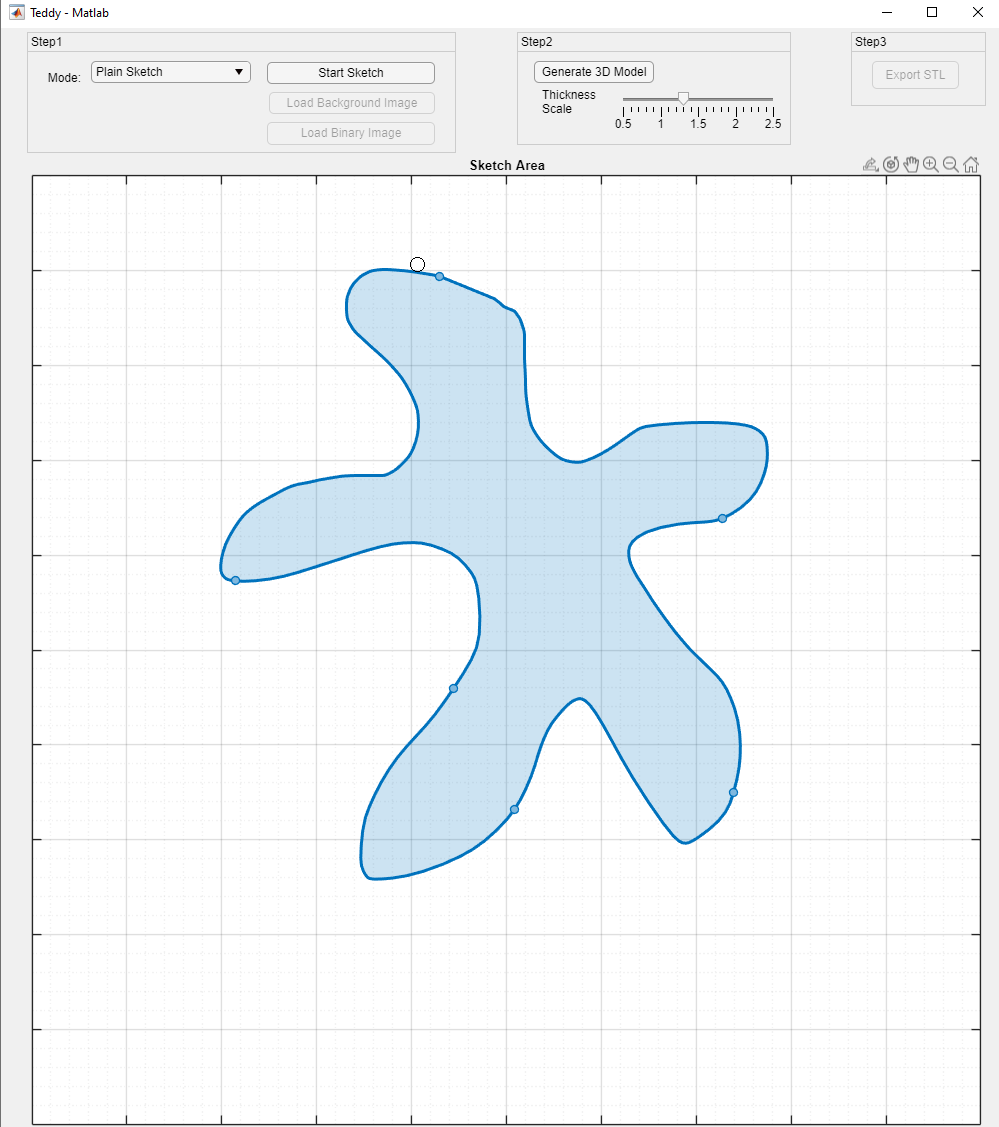

1. Plain sketch:
- it allows the user to draw a closed contour on a blank canvas freely.
- The user can press the left mouse button, and move the mouse, and the program will trace and draw the path the mouse undergoes.
- Once the left mouse button is released, it automatically closes the contour by connecting the last point before the button is released and the initial point.
- Once the contour is drawn, several "waypoints" are automatically generated. The user may manually drag and move those waypoints to change the shape of the contour. The user may as well add extra waypoints by right-clicking when the cursor is on the contour.

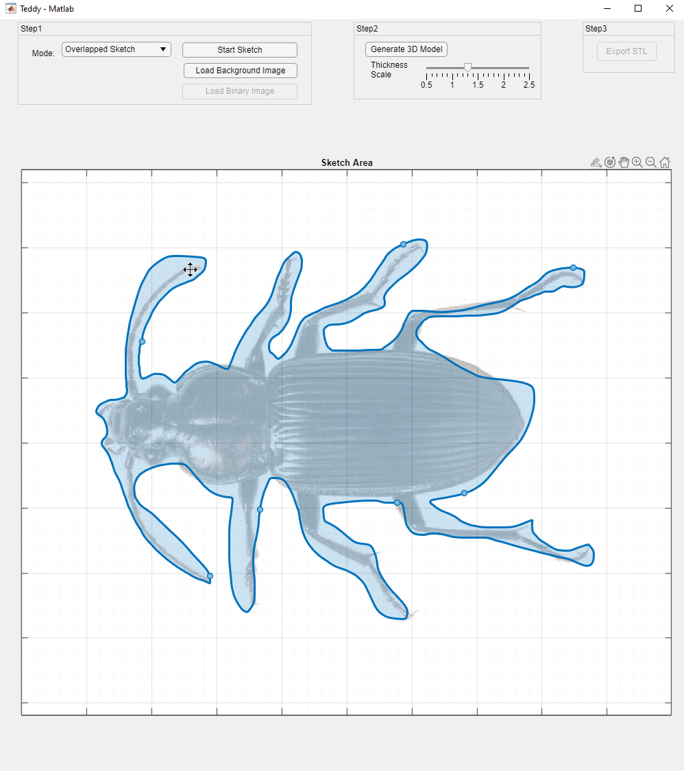

2. Load an overlay image and sketch:
- The user can choose to load an image as the background, and then sketch on top of the background image. The sketch process is the same as the "Plain sketch" mode, and the background image assists the user in tracing the feature/outline of the image.
