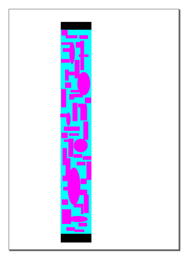

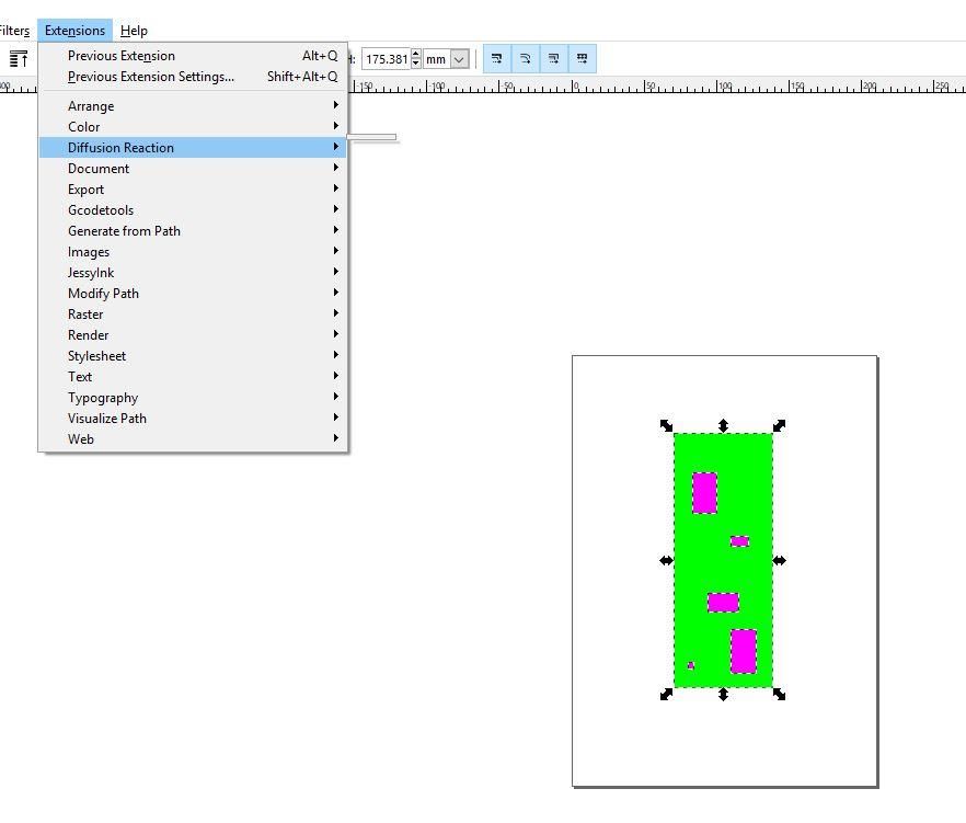

With the traced out shapes from step 2, I created a solid object in one colour. I then put a black background behind the object to create a rectangular-shaped boarder. The extension converts the input into a rectangular bitmap and treats the world as a torus (so the edges match). The bits in black tell the extension not to simulate the pattern there. I then covered the shape with a bunch of other shapes in another colour, this doesn't really matter much, but these shapes act as "seeds" for the pattern to work from. By having lots of "seeds" it means that the simulation needs fewer cycles to propagate fully around the shape. This is good because the simulation is pretty inefficient and takes lots of time anyway. To run the extension I went to "Extensions>Diffusion Reaction". It comes up with a prompt about how many cycles to run for and the dpi (dots per inch). Higher dpi and more cycles take longer but may create a more complex and finer pattern.
After running the simulation, it should insert the pattern back into the Inkscape document in the same position as the original shape.
As I mentioned in the previous step, this extension is very unpolished and isn't a very robust piece of code, but works well enough for my purpose. Given it is written in python and is running many operations over a large 2D array, it isn't the most efficient, so it might look like Inkscape is frozen while it is running, but it does eventually finish.
