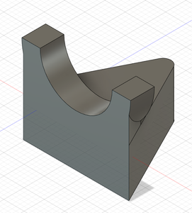

Next, we designed the supports that connect all the pieces together. We also created a replica of our rolling pin in Fusion to make sure everything fit. There are three types of supports in our design.
Stands: The pieces in the shape of a triangular prism. In our design, the base is made to slot seamlessly into our slanted floor (see Step 4). The shape of the stands prevents the marble from getting caught on them.
Holders: The hollow pieces that will sit on top of the stands and hold the rolling pin. From our testing the marble rarely gets caught on the holders, so the design is mostly for aesthetic purposes to match the stands.
Pillars: The cube-like pieces that will be attached on top of the rolling pin and provide a flat surface for the track.
Make sure to size the holders and pillars to fit the rolling pin.
