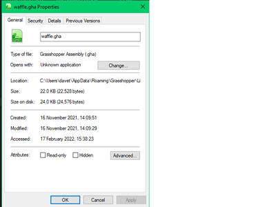

Download "waffle.gha" from Food4Rhino (https://www.food4rhino.com/en/app/waffle) , and example files from Parametric House (https://parametrichouse.com/waffle-structure/).
Put waffle.gha into your components folder within Grasshopper.
Restart grasshopper after you've done this.
If it still doesn't work, then right-click the "waffle.gha", and make sure it it "unblocked" under "properties"
