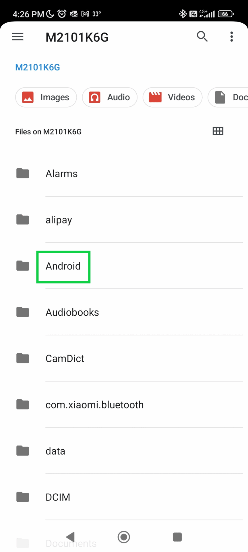

- Snapshots saved to your phone will be saved to the private folder of DumbDisplay app - /<main-storage>/Android/data/nobody.trevorlee.dumbdisplay/files/Pictures/DumbDisplay/snaps/ -- with file name like 20240904_223249_001.jpg (YYYYMMDD-hhmmss_seq.jpg)
- Offline snapshots transferred to your phone will be saved to a subfolder of the above-mentioned private folder of DumbDisplay app. The name of the subfolder depends on the time you do the snapshots transfer, and is like 20240904_231329_OFF.
- Offline snapshots are saved to your ESP32-CAM's flash memory / SD card with name like off_001.jpg. Note that the "offline" JPEG files will only be properly time-stamped if there was no reset / reboot of ESP32-CAM after connecting to your phone.
By default, the storage for DumbDisplay app is a private folder, which DumbDisplay app needs to initialize. You can do this By selecting the Settings menu item of DumbDisplay app, and clicking on the Media Storage button
And you can use a folder manager app, like Files by Marc apps & software to browse to that folder
